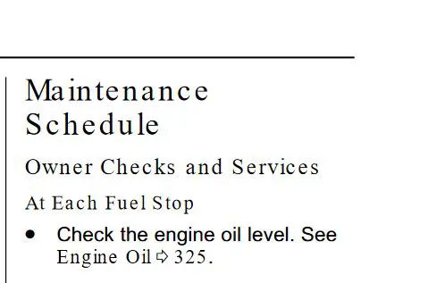

According to my 2017 Chevrolet Suburban Owners manual, you are doing the right thing. On page 412 for the Maintenance Schedule, in the upper right hand corner of the page, it says that you are required to, at each fuel stop, check the engine oil level.
