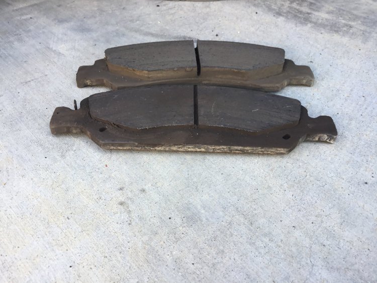

So this is normal? Front inside pads were destroyed, just turned 35K? Very little towing (maybe 1K miles towing camper and 1k towing landscape trailer - no brakes at 3K #s), but swapped to mud tires at 28K miles. So I am guessing the heavier tires and the towing had something to do with it, but the brake squeelers never made a noise, and the rotors were toast.
Unfortunately with the crappy recycled steel they use for rotors they tend to rust badly and brake pads don't like stopping on rust. Most ceramic brakes will last 100k if the rotors don't rot out first. Don't get me wrong, I make a lot of money replacing these crappy rotors and the pads they destroy. With the price these trucks cost they should maybe spend a little more on some quality rotors.
