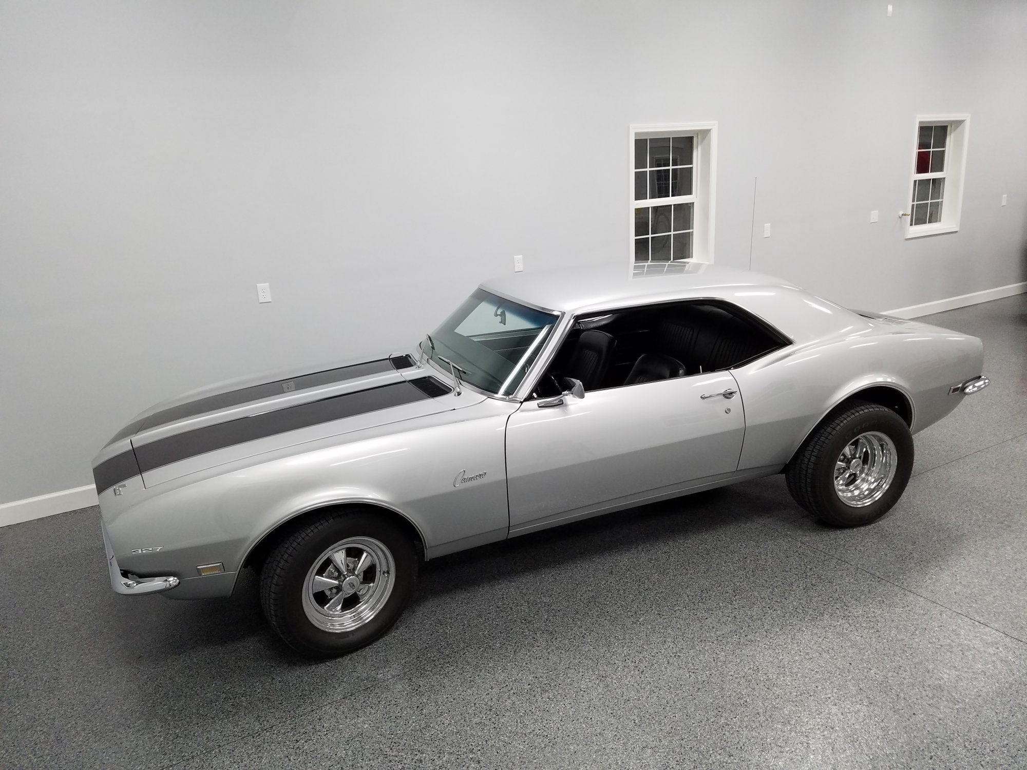

Trading the Denali this weekend.  After owning GMs since my first one when I was 17 (43 years) I will now only own my first one - a 68 Camaro.  It's active fuel management uses my right foot, and I decide if I want to get 8 or 12 mpg (2 or 4 barrels open!)
