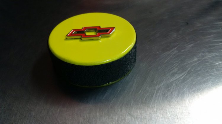

Joe's 2017 Silverado Posted January 21, 2018 Share Posted January 21, 2018 I have a 2017 Silverado and assuming the newest Silverado has the Capless Fuel cap / Fuel Filler. I see that driving through dusty environments, wet & snowy weather the fuel door does not seal against outside environments things can accumulate on the capless fuel filler. I figures out that the outside cap dimension is 6cm = 2.36" wide. I could use a trailer bearing cap with is the same width or just slightly larger or a rubber bearing buddy cap that is 2.44" = 6.20cm wide which both fits right over with the metal trailer bearing cap being a bit more snug. Check out the photo's below. To buy them I just went to the local RV / trailer supply place. Hope this will help anybody looking for a cost affective way to keep sh*t off of the capless fuel filler. 1 Quote Link to comment Share on other sites More sharing options...
