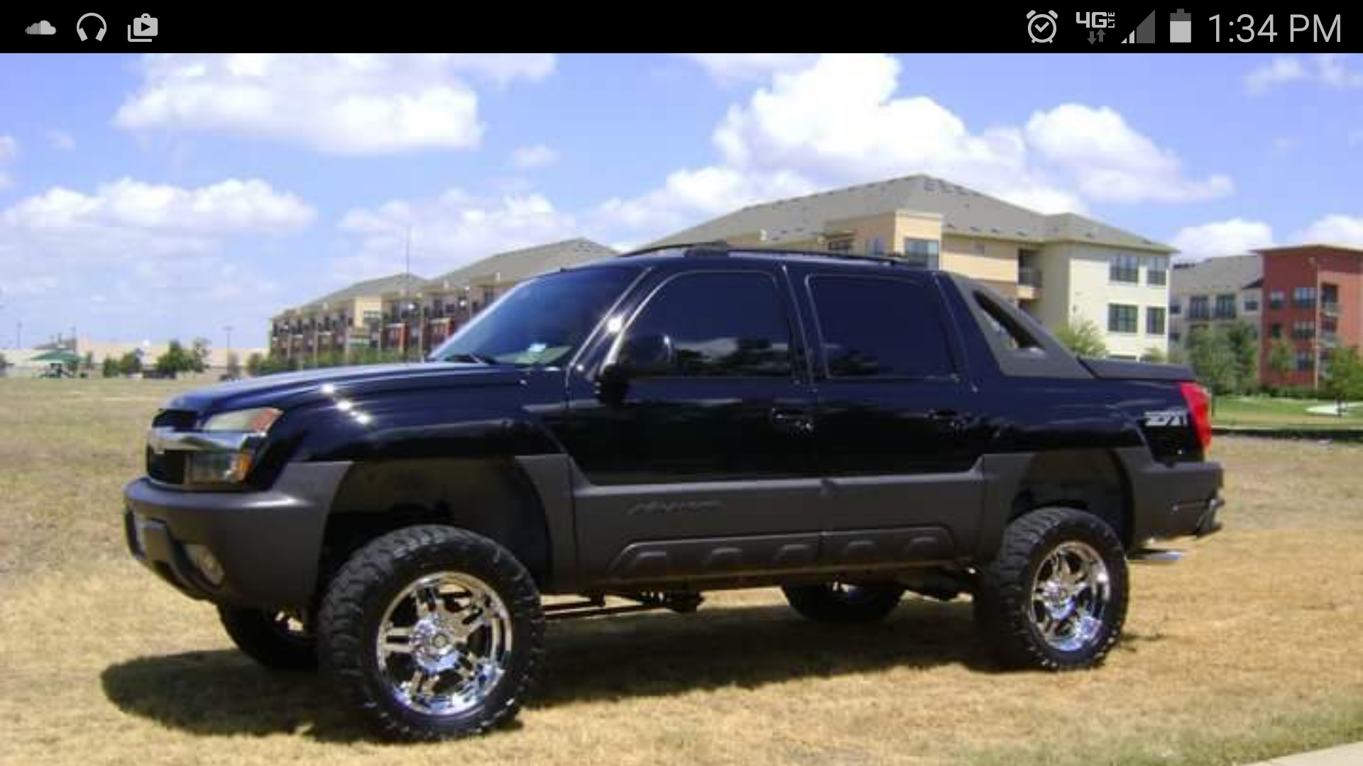

I used a Rough Country Lift on my Chevy Avalanche back in 2010 and had no issues with them.  When I received my kit, I did an inventory take-off prior to installation and found they gave me two rear brackets as opposed to a front and a rear.  I contacted customer service and they sent me the correct one overnight.  A year after having my kit, one of the brackets had a hairline crack in it and the again, sent me one overnight saying it was a known issue and beefed up the design.  So I guess yes, technically I had an issue or two, but they stood behind their product and corrected the issues within 24 hours.  The truck ran sever years without any issues with the lift.  I do recommend buying Rancho Shocks as opposed to the ones they supply, even the sales guy admitted the shocks weren't the best.  But then again, all my previous lifts, I swapped out the shocks that were provided with the kit anyways.  Contact their customer service with your issue and see if they can help resolve it.  Best of luck! Screenshot_2016-07-08-13-34-22.thumb.png.ade924f350ed28e280cdd4c3c814d4b6.png
