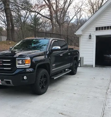

Thanks a lot! That is exactly what I was looking for. Do you have any pics you can send? I also feel the same way with the stock ranchos and front being so low. I plan on removing the air dam as well.

See attached (the wheels are granite alloy 20" similar size to stock wheels) the stock blocks are 1.25" the replacements are 2.25" I think I got them from ready lift or something - there are a number of vendors that make them. Has some rake to it, doesn't ride w/ a sagging rear even w/ max payload in bed FWIW.
