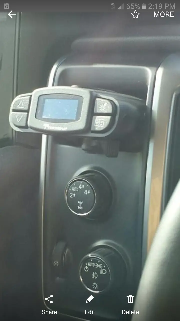

Also I do not currently have my P3 installed on the 2015 and if I did need it would install it in the cubby as shown in picture. Don't know if my long legs are to blame but when controllers have been mounted under the dash I often bang my knee on it.  Have no desire to have that continue to happen.

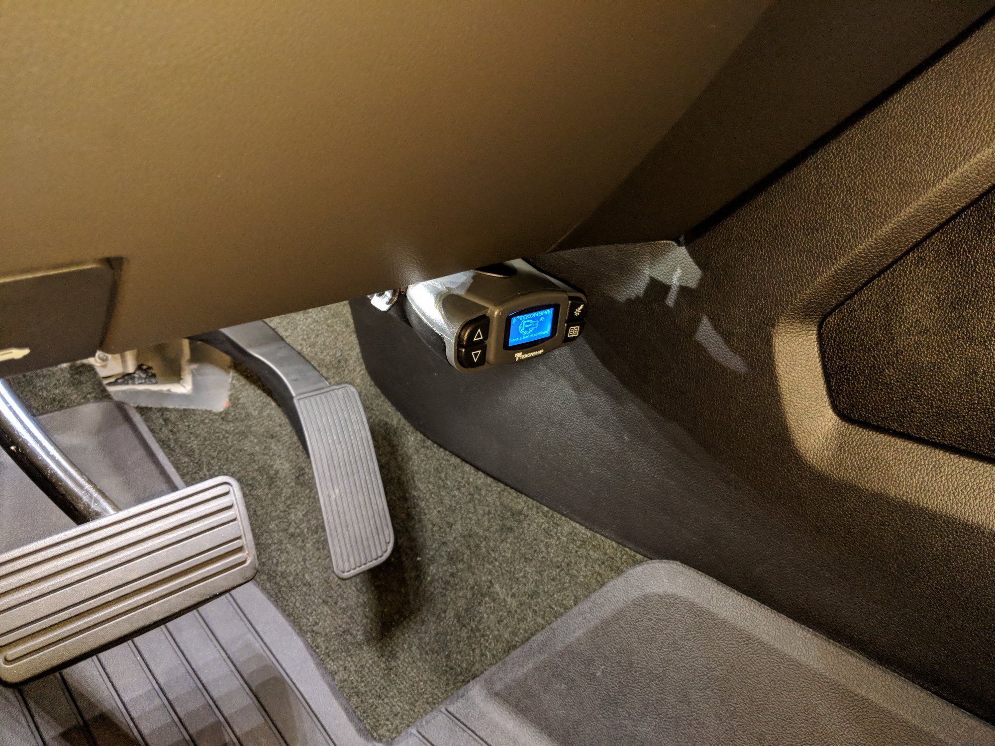

I added the P3 today with the plug n play harness. Definitely spend the $15 for the harness. Couldn't be any easier!  Took 15 minutes to install. I had a hook and pick set which I used to open the left side of the electrical box because it is impossible to get your hands back there to remove the cover.
I don't know if you have much experience with a brake controller, but that is way too low to reach to manually toggle your electric trailer brakes.    I hit mine manually every time I hook up the trailer to make sure I have the controller set at the right amount of drag.
