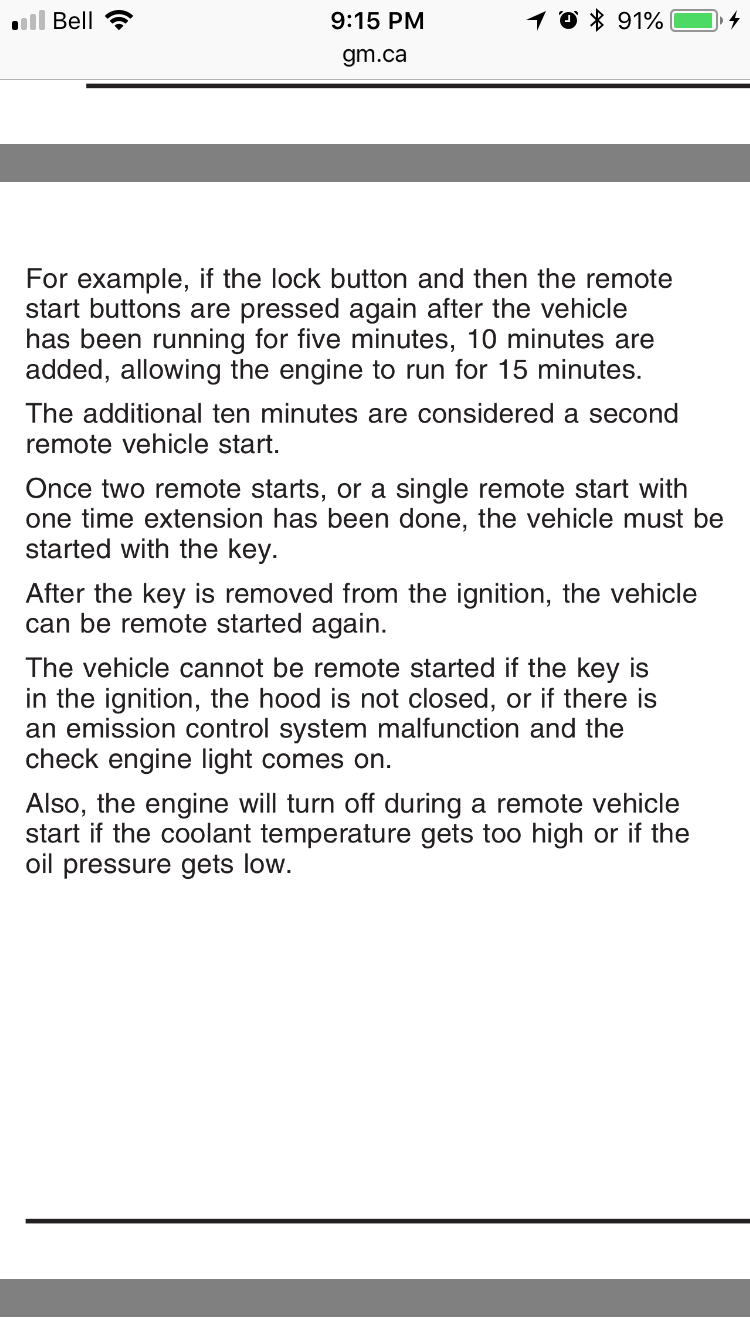

If your truck has remote start, make sure it is enabled in the driver information center (dealer turned mine off during a service visit for some reason, and I thought it was broken until I discovered that it was off in the DIC and turned it back on), and that no fuses are blown.  Also, remote start will not work if there are any Check Engine or other trouble codes present.  All doors have to be shut and locked, hood too.  You can only do 2 remote starts for 10 minutes each and then you have to use the ignition key to do the next start.  No time limit or cooling off period that I'm aware of.  If your truck is supposed to remote start, I'm betting there's another trouble code being thrown somewhere.

 99% of the time, if the truck responds in any way to the key fob, whether it be flashings lights on the vehicle, crank attempts, etc, then the key fob is most likely not part of the problem, and you should start looking at the truck itself. Once the truck responds, the key fob has done its job. However, having said that, there was only one time I can remember a customer of ours had a beat up fob for a OEM starter, and it was so worn out that when he pressed the buttons on the fob and remote start activated, the button wouldn’t release properly and would act as if the button was still being held down and remote starter would think customer wanted to quickly shut the starter down.  Chances are you are looking at more of a vehicle issue, where the following conditions would cause a remote start malfunction:
-low battery voltage
-hood latch open (grime/ dust/ dirt/ rust/ out of adjustment hood latch could cause a false reading)
-Low oil pressure
-coolant temp too high
-key in ignition barrel
-Check engine light on
-remote start has already been utilized 2 times before another ignition cycle
