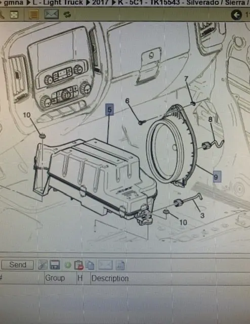

just got off the phone with GMC parts and he said this is in my truck.. part # 22818981
where do you recommend I go to look at upgrading this and making it plug and play?
Edited by 99Mastercraft
By upgrade, do you mean the sub, or all 7 speakers?
"Plug and Play" is a loose term. ?
I "plug and played" my door speakers (to start off), with relatively low impedance Focal speakers and it was fine. Better. Not great. Fine.
The sub is not really PnP, because it is integrated into the Bose amp (mine was mounted on the rear cab wall). It can be replaced, but you need to make sure the replacement gets the right signal and has its own amplification. I think Kicker has a product for "just sub" replacement in the center console, or under the rear seat.
By the time I got to my sub replacement (JL Audio Stealth), I had already replaced the Bose Amp with a pair of JL Audio amps (huge improvement), and upgraded dash speakers (much better mids). That meant installing a NavTV processor that allows the aftermarket amp stuff to use the headunit signals but keep the door chimes, phone, and environment sounds. There are other similar solutions out there now.
At that point, replacing the JL Sub in the center console was PnP...and is an awesome upgrade.
