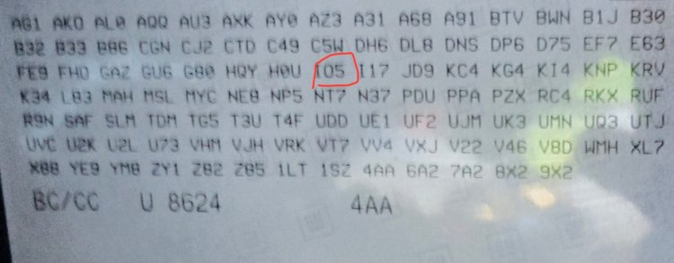

TammyCowan Posted July 1, 2021 Share Posted July 1, 2021 I know this is a dumb question but how do I find the screen inches on my 2015 Sierra. Someone broke mine so I need to replace Quote Link to comment Share on other sites More sharing options...
JimCost2014 Posted July 1, 2021 Share Posted July 1, 2021 47 minutes ago, TammyCowan said: I know this is a dumb question but how do I find the screen inches on my 2015 Sierra. Someone broke mine so I need to replace Take a picture and post it, that way we can give you a good answer. You can also look in your glove box at the RPO codes, IO3 Radio – Infotainment System – Base IO4 Radio – Infotainment System – Base With Connectivity IO5 Radio – Infotainment System – Uplevel With Connectivity IO6 Radio – Infotainment System – Uplevel With Connectivity And Embedded Navigation First two will be the small screen, second two will be the 8 inch screen. 1 Quote Link to comment Share on other sites More sharing options...
MikeBMW Posted July 1, 2021 Share Posted July 1, 2021 (edited) 1 hour ago, TammyCowan said: I know this is a dumb question but how do I find the screen inches on my 2015 Sierra. Someone broke mine so I need to replace Look into your glove box at the build codes. If it's an I05 or I06, it's an 8" screen, otherwise, it's something else. Sorry, this was just a quick pic, edited - only difference between I05 and I06 is factory nav. @JimCost2014, nice work, you're a lot faster than me! Edited July 1, 2021 by MikeBMW 1 Quote Link to comment Share on other sites More sharing options...
