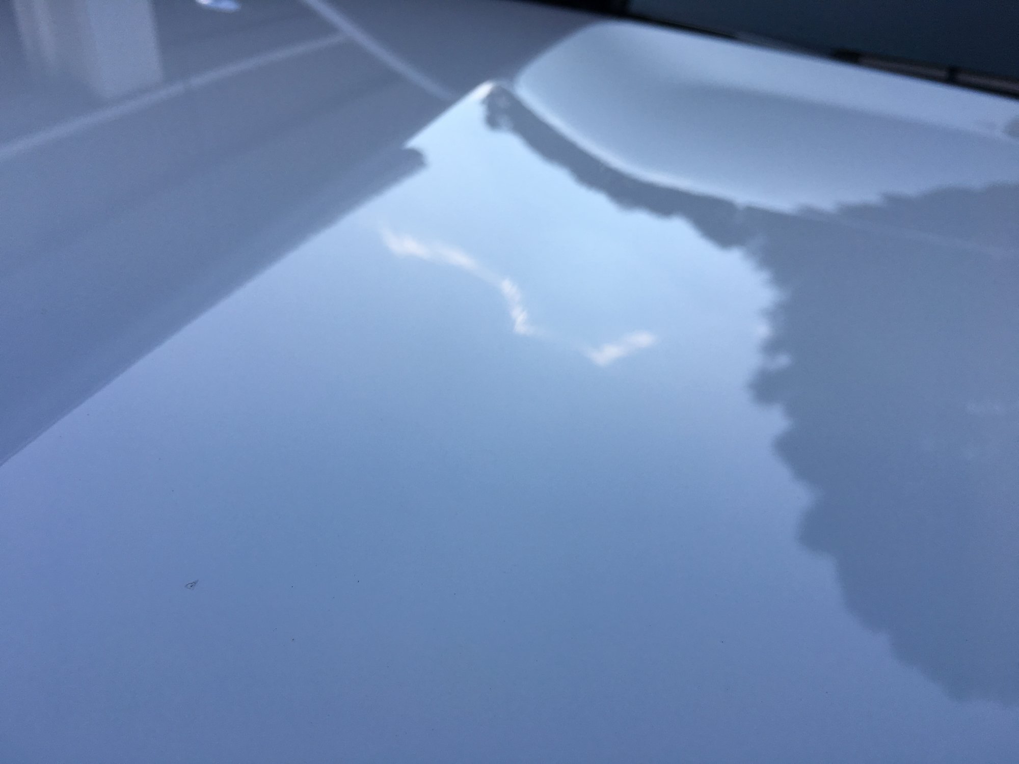

Hey all,
 Just washed the 2018 and found 2 rock? Chips on the top middle of the hood.
Guess I could attempt to touch up with a touchup pin. Would you just put clear on the chip? Looks like it’s not down to primer.  Of course it will be tough not to create a bubble of touchup.
Any good techniques?
This happening to others?
Truck just turned 6 months old!
You will want to fill the chip with either paint/clear or clear. After it dries, you can wet sand using 800/1600/2000 grit. Don't press hard and take your time. If you do it right and don't get through the clear coat around the chip, a good coat of sealer polish should make it uniform. If you are uncomfortable doing this tedious task, do to a detailer or body shop and get their opinion.
