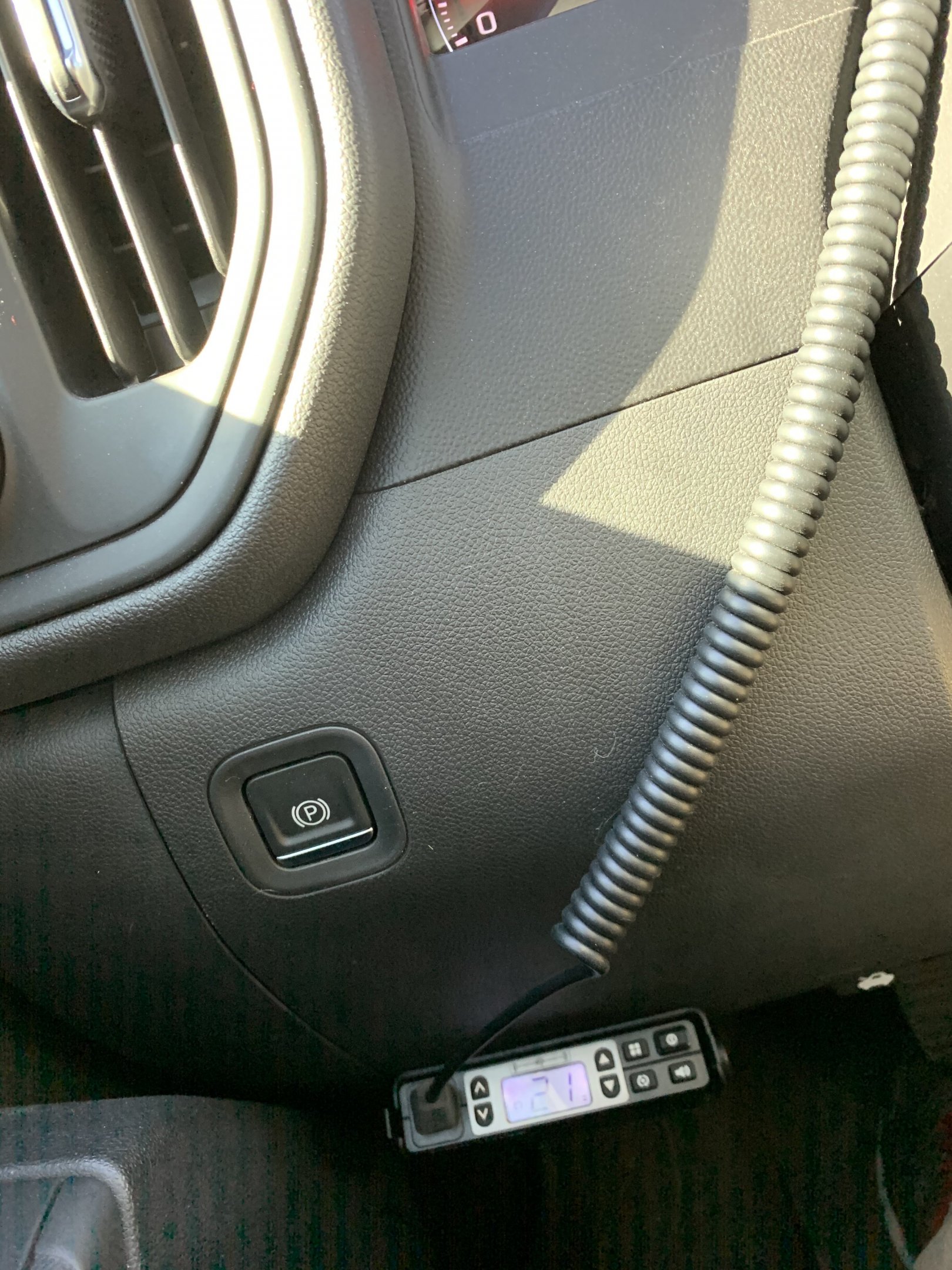

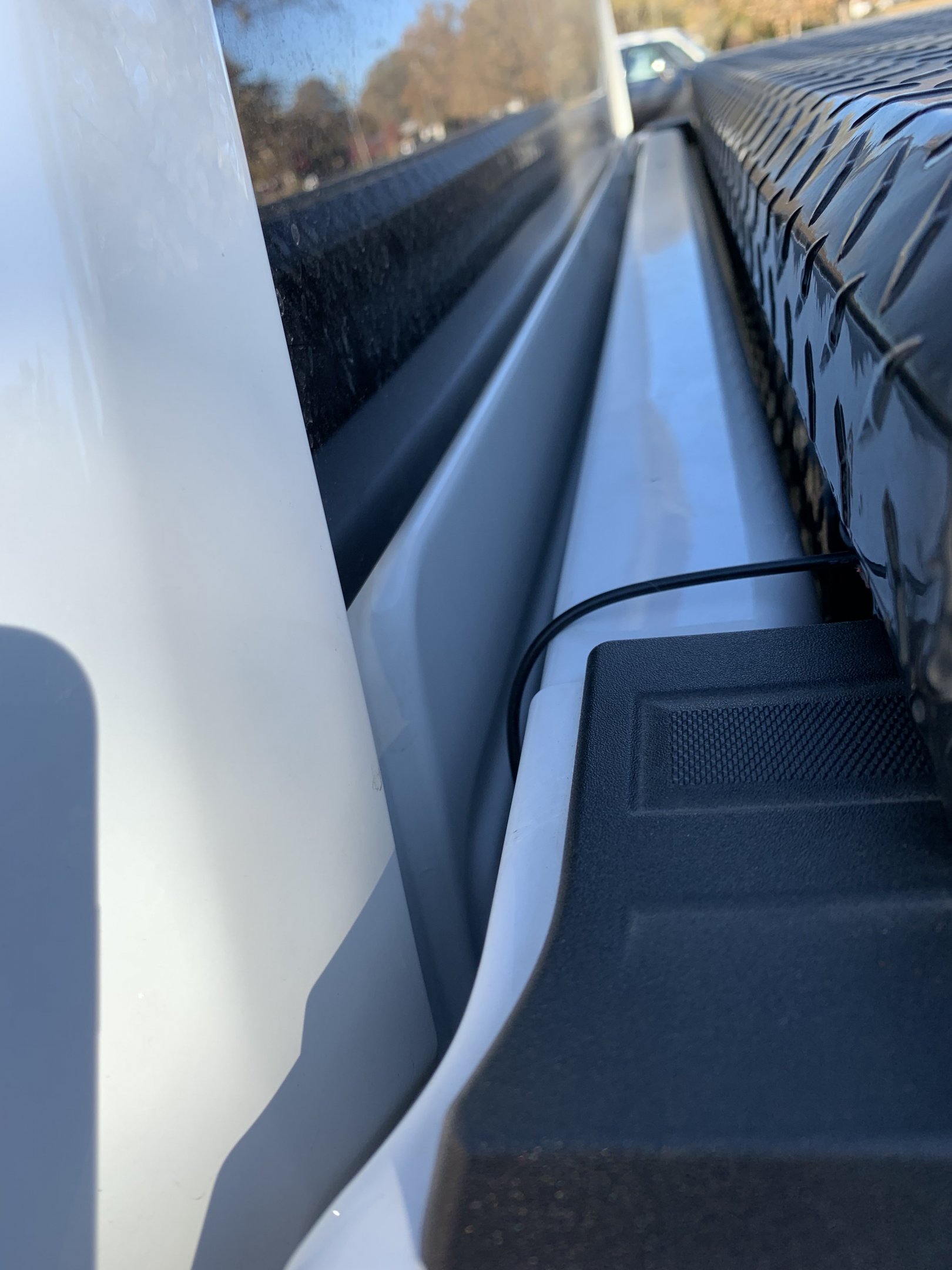

Finally installed my GMRS radio and antenna on the new truck. Did it the most non-destructive way I could.. I know I could have routed the cable through the bed itself by popping out one of the plastic covers, but I opted for just routing over the back and under the toolbox. Using the toolbox itself as an anchor point for the mounting bracket.
Used zip ties along the bottom to make sure the cable didn't move around. The cable itself is 6M.. which was perfect for the route I took it. Also, excuse the dust, it's a losing battle here in Kansas.large.IMG_4148.jpg.43c0a090f904a3fa5cd9e4bd2e4a328f.jpglarge.IMG_4149.jpg.651450a5a80b2ce361f67a6986226a42.jpglarge.IMG_4150.jpg.c629d3322794ee8d92c92b24e13e6ab8.jpglarge.IMG_4151.jpg.bb5eb55cdcc2ba6c4cb754a3d22f601b.jpglarge.IMG_4154.jpg.1cd234a735a169f93a455352f882e615.jpglarge.IMG_4155.jpg.16d8f6e288a4822c25877d6bccf90a1e.jpglarge.IMG_4153.jpg.5bb9d5377d07702cdfdf99c601bac9f5.jpglarge.IMG_4152.jpg.f0da5bbc88f4bb73e304cec3e8bfc3f8.jpg
