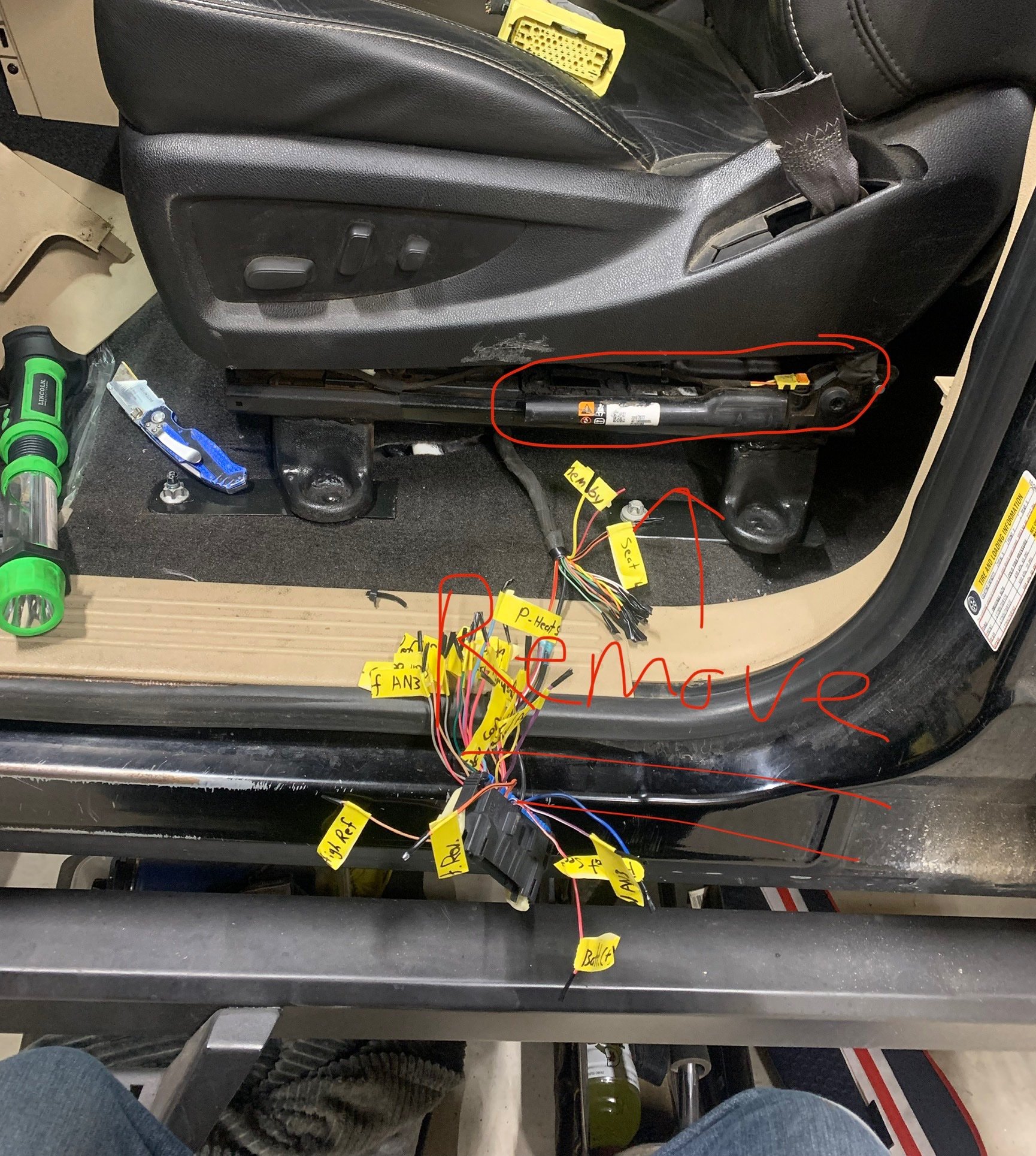

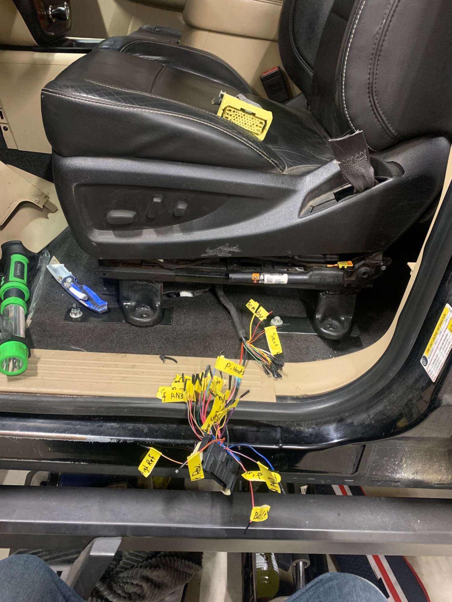

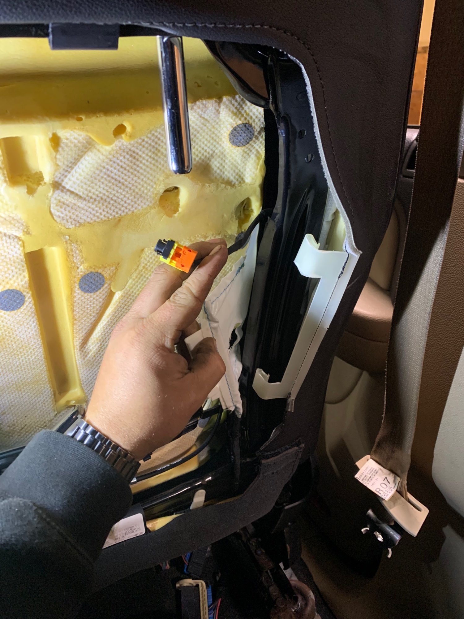

On 5/8/2022 at 1:54 AM, Yount166 said:
Couple more pics here. Just how to unhook the airbags in the seats and one of the seat belt tensioner that can be removed when retrofitting. Your 08-13 seatbelt will bolt in as well, just you have to turn the locking tabs until you find a spot where it tightens down flat. (Not perfect fit but will work fine) .
