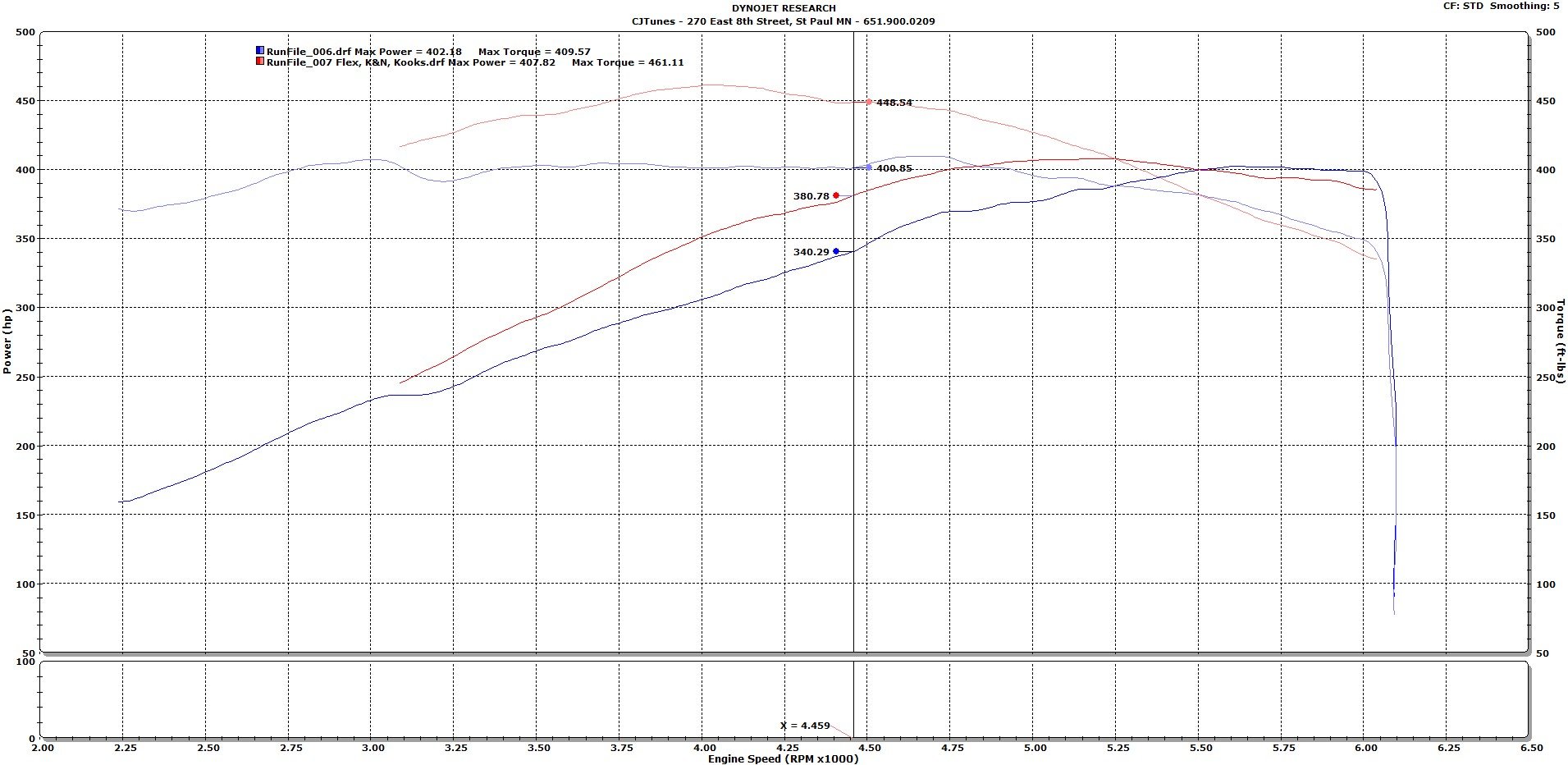

I have a ported MSD on my 6.2 and it pulls up top from 5500 to 6k but gave up alot in the mid range.  The L86 intake is done at about 5250 and the MSD will flat line from 5500-6k (at least on my truck).  Makes more hp and tq from 5500 on but don't drive there.  Red is stock L86 intake and blue is MSD.

What other mods do you have? That’s some great data btw and the first time I’ve ever seen a comparison dyno of those two.
L86 intake rocks, wow
