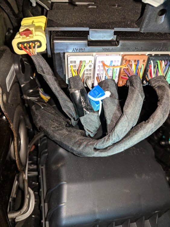

Need a diode to have your cargo lights follow the reverse lights.

On 4/23/2020 at 3:46 PM, Alexquade said:
So just wondering, this will turn on the cargo lamps when unlocking, will it turn them on when reversing? What about when you turn on the cargo lights manually?
Turns cargos on with reverse.  Turn the diode around and it will turn the reverse lights on with the cargos.   If you want both to happen, use a wire instead of the diode.

13 hours ago, kyles1919 said:
Hi! Is this pretty simple? I am dumber than a plank when it comes to anything with wires.
Depends on which "this" you're referring to.  Diode/wire jumper?  It's fairly easy.  Found it easier with a set of jeweler's screwdrivers.  Used either the awl or smallest tip philips to work an opening in a corner for the diodes that I've installed.  If you use a wire jumper, get a 18-20 gauge SOLID wire to make the jump.
On 11/23/2021 at 6:52 PM, kyles1919 said:
I will be using a diode. i appreciate the response!
