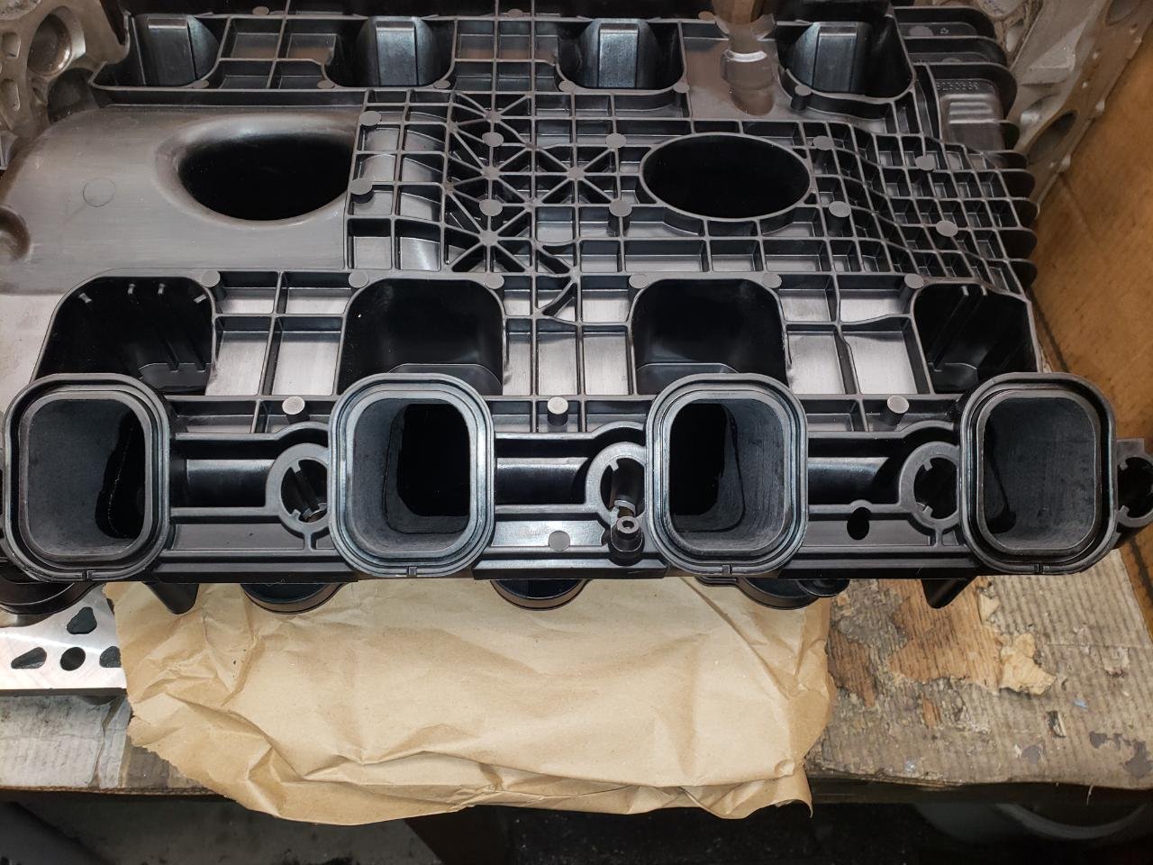

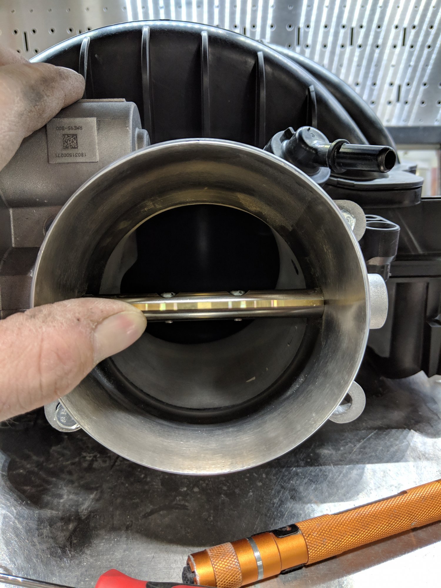

Now, The one thing that I have NOT been able to find is a Larger Throttle body that will fit the L86 Stock Manifold. So I did what most have done and ported that sucker out. The only issue is it will never be larger than 87mm. Until this came along.
https://www.bbkperformance.com/92mm-throttle-body-14-18-corvette-camaro-lt1.html
FYI slight modification is required to the stock Manifold. You need to shave the base of the Vacuum port as well as the MAP sensor base for the frame to fit. Once that is done you're rocking.
 IMG_2412.thumb.jpeg.6da6f0fb3afd00dd4aa75f0df105717d.jpegIMG_2413.thumb.jpeg.de9957819234a7fa613aa72387e1fd08.jpeg
I was able to Port match the TB Bore to the manifold inlet and smooth out the transition. Honestly I can immediately feel the difference. When I get a little bandwidth I will throw on some videos of Cold/warm starts, take offs etc.

How much did you have to take out of the tb opening to match the new tb? Numbers would be awesome, BBk doesn't claim any more power then a ported throttle body so it kind of turned me off the idea, especially when you have to port match the manifold. But they don't have any charts either.

So you can do either or. File down the base just until the TB can fit, or file down the TB on the side and corner until it fits. Not much at all maybe 1-2 mm worth. Does NOT effect the sensors at all.
Sorry misread that. For the actual Intake manifold I had to take quite a bit OUT to remove the "bump" or difference from TB to Intake.
