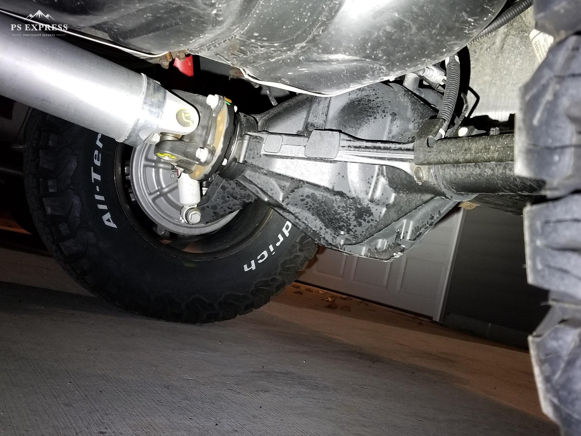

The end of December, I noticed a small amount of oil on the garage floor under the front of rear differential of my 2WD, 2019 High Country.   It appeared to be a pinion seal leak.  The Dealership concurred and ordered a new front yoke and pinion seal.  Today, the Dealership called and informed me that GM did not have the parts so they sent a Complete new rear Differential as a replacement!!  Now they need my truck for a Full day to swap rear ends.   Appears to be an EXPENSIVE way to replace a $10 part, but GM must know Best!?

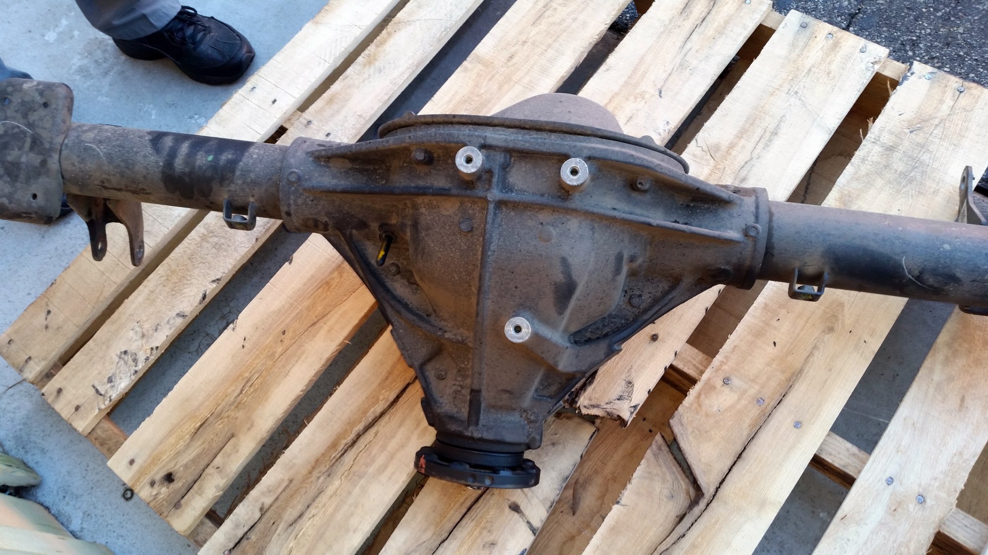

Thanks for the suggestions.  The rear was replaced today and Everything seems fine.  No clunks or vibrations and Truck drives smooth.  Photo below is old Rear with 10K miles on it.  You will notice the oil stained area around the pinion where the oil was being slung from the leak!
That's a resign from previous generation.  Perhaps they did want to inspect a virgin unit.
