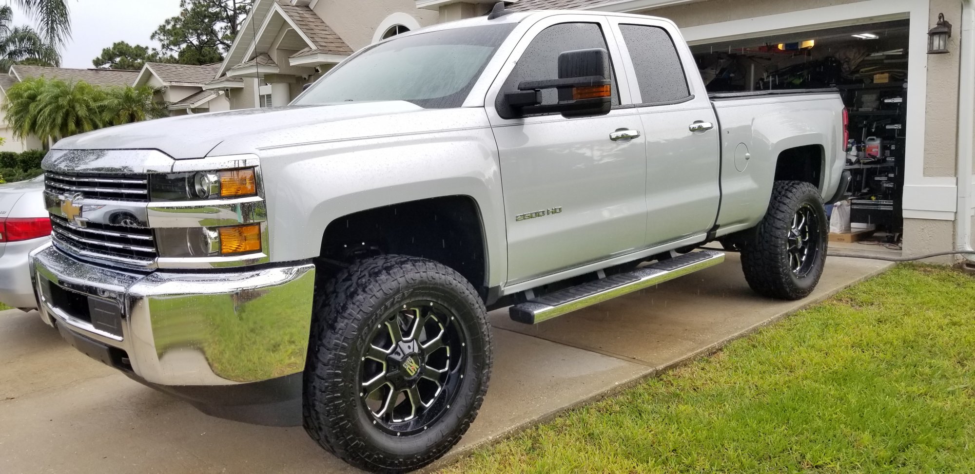

Here's a pic since I posted the original post.
I installed everything myself in an afternoon.
Kryptonite UCA's with OEM shocks and extenders. Suspension Maxx Keys, Toyo open Country AT2 Extreme 35" x 12.5" wide, with Fuel 20" rims 0 offset
After alignment,  I ordered the Bilstein 5100's for leveled trucks, and used the spacers. I hated the ride for city/ highway. I stiffened it up enough that I pulled them back out, and installed the stock Rancho's with spacers back in.
I'm completely happy with the ride again, and with the 35" tires, it feels allot softer of a ride.
I also shimmed the front bumper out 1/2" to clear the tires, and alittle trimming, nothing else needed, no more rubbing
