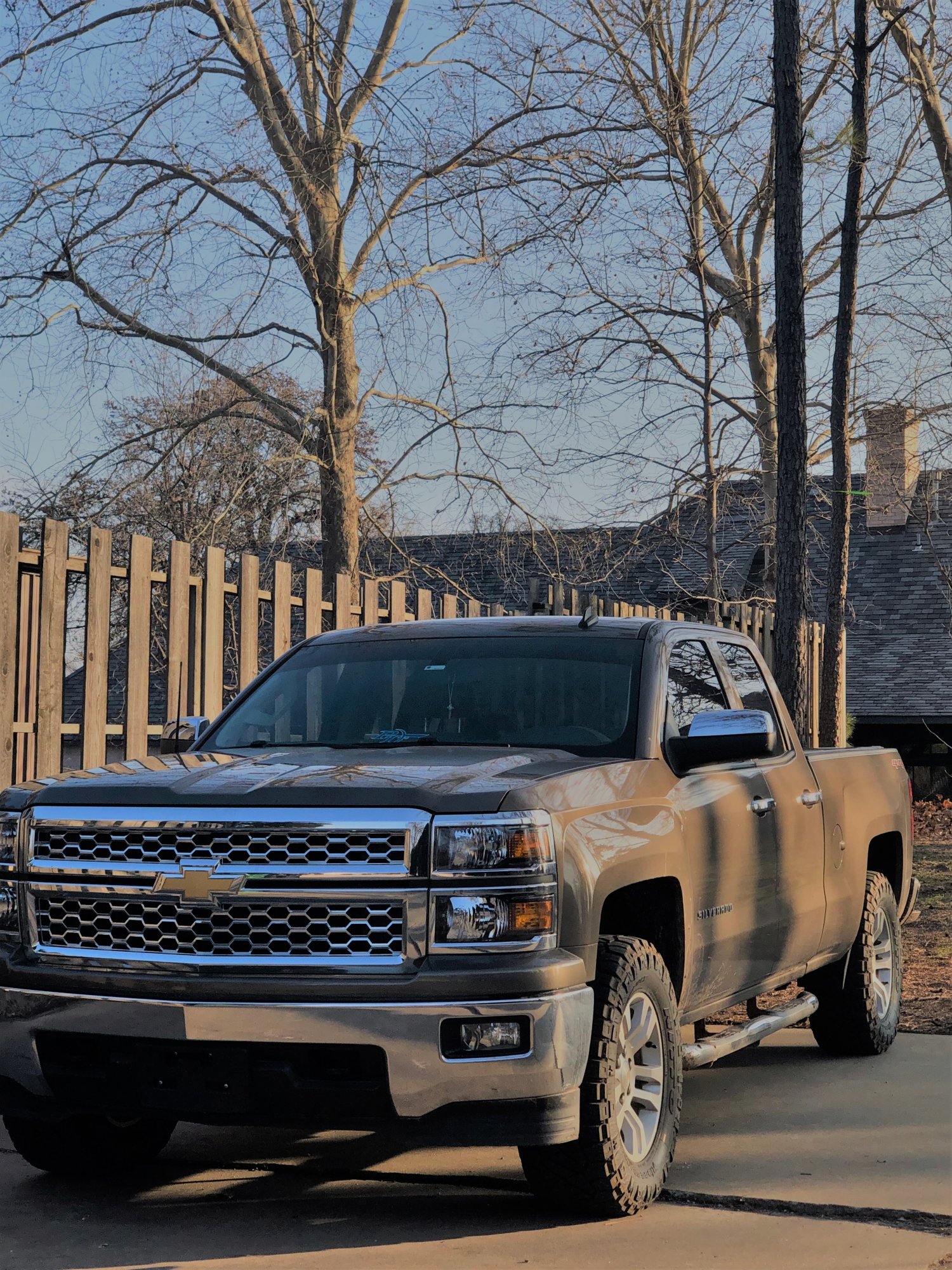

I had and liked the KO2's but when it was time to replace them recently I decided to try the Nitto Ridge Grapplers because of the 75k mile warranty (vs the 50K KO2). 33x12.5x18 fit perfect on the stock rims and with a level kit in the front I've had no problems with rubbing at full lock in either direction.
The Ridge Grapplers ride smooth and quiet on the highway but the best part is the improved traction on and off road. These are truly a Hybrid tire because the tread is more aggressive than the usual A/T but slightly less depth than M/T.
