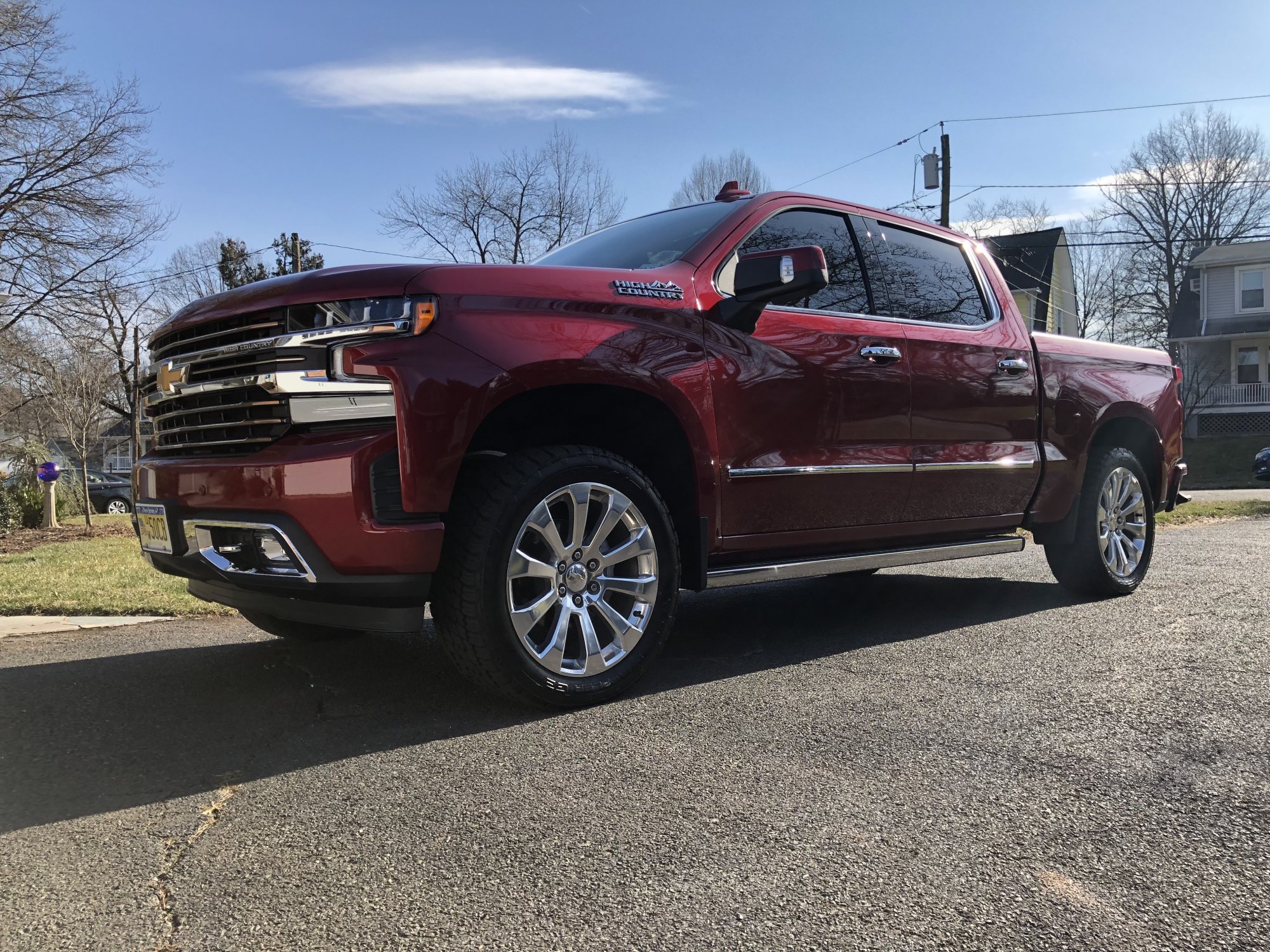

On 2/23/2019 at 2:33 PM, eppieguy said:
No problem, a couple of whacks on the knuckle and tie rod pops right out, very easy. Like I said, I was done in about an hour and a half by myself and that included getting tools, jacks, jack stand and cleaning it all up. Post pictures when you’re done!
looks great. what tires are you running, specifically what size??
Nitto Terra Grappler G2's 305/45R22
