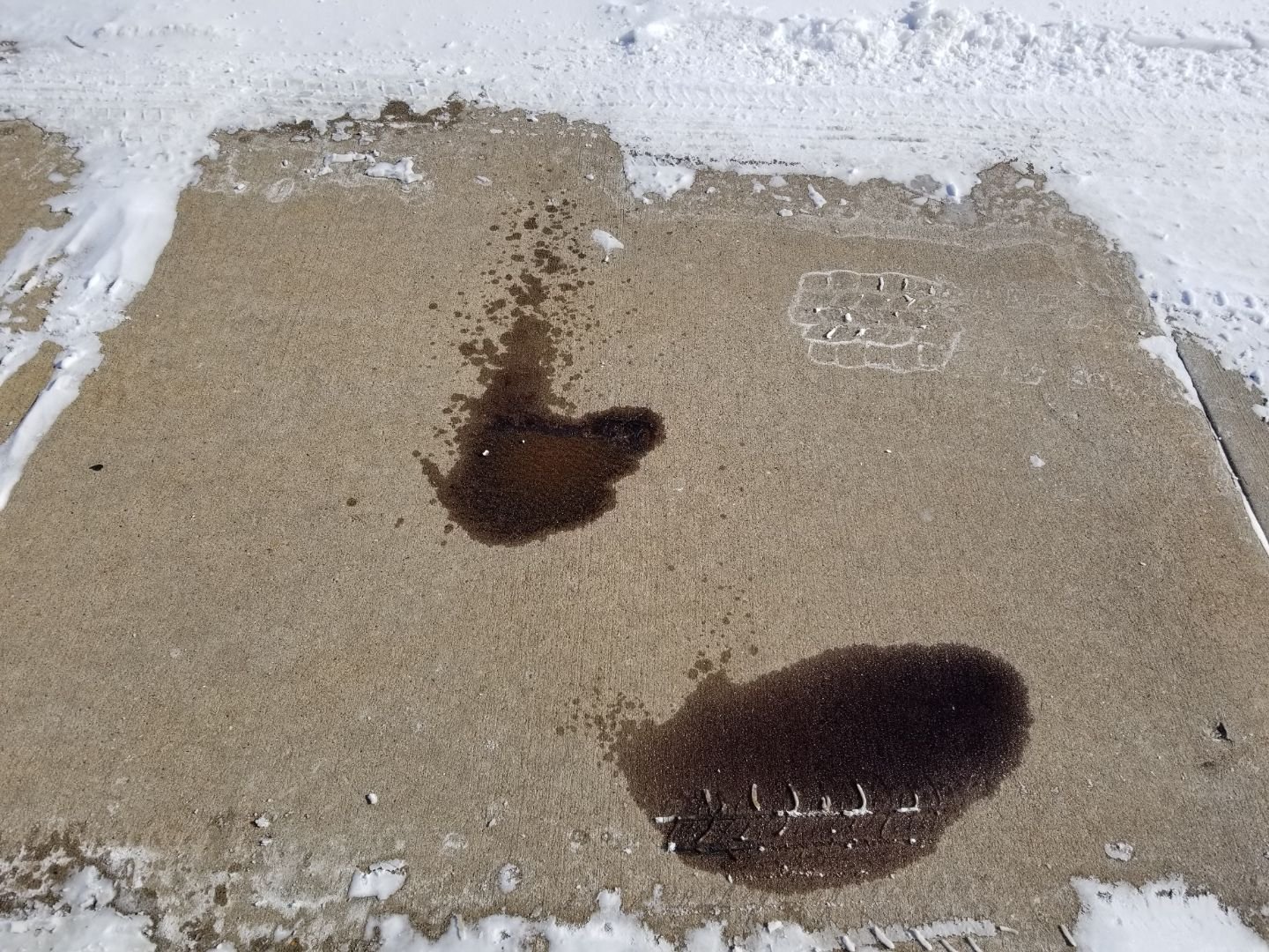

I had the same exact issue the last couple of days. I checked the driveway and the spots were a little bit bigger than I was expecting.
ha! that looks just like my driveway!
