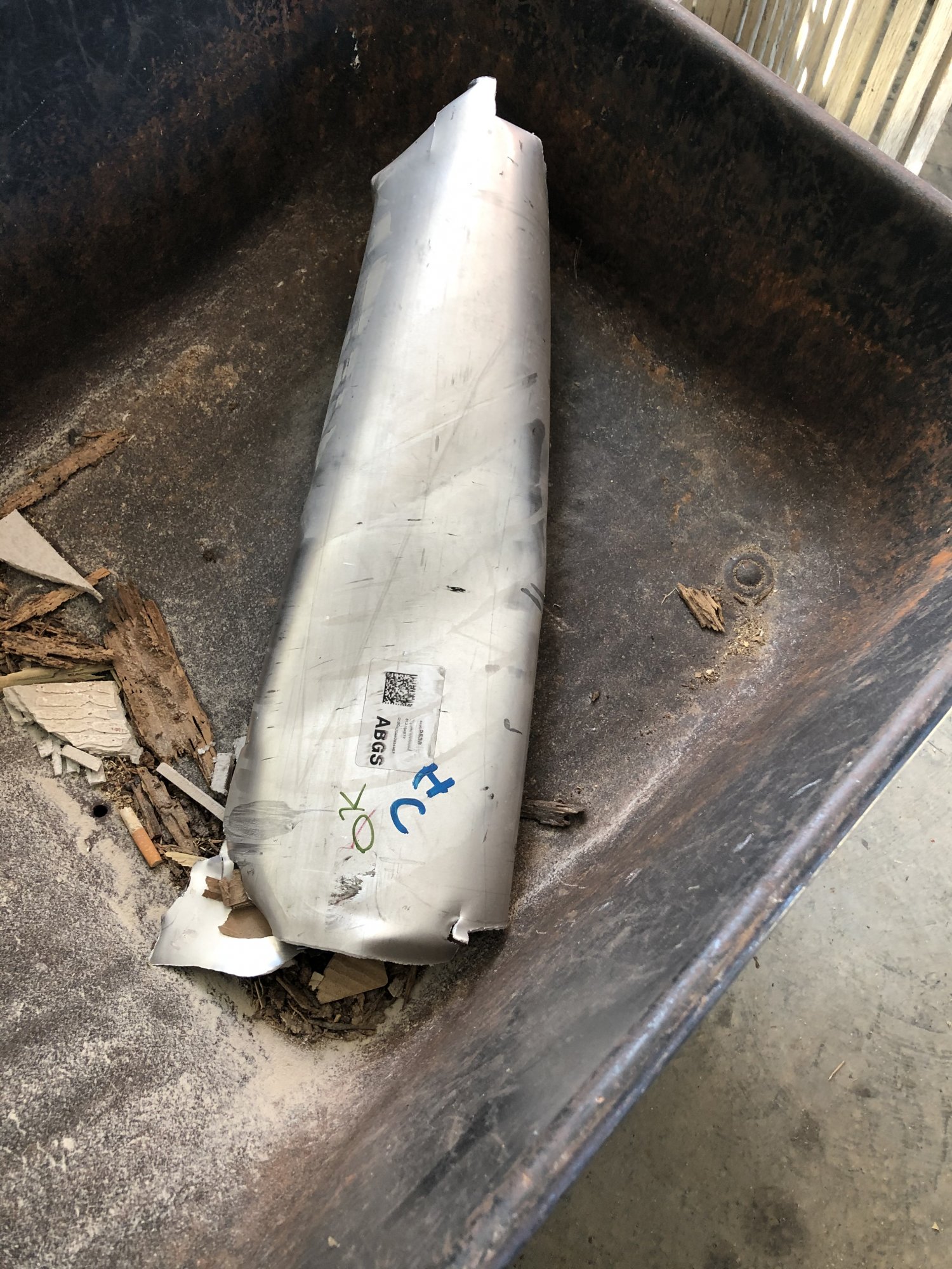

I decided to play and pay too. Took the speed limiter off, pulled to 110 like a beast then BOOM I had a 3 piece drive shaft. No mods other than speed limiter off. At dealer now hopefully won’t be too bad. Got lucky didn’t see any other damage and nothing leaking. Center piece shown. Other ends are still attached to truck.
