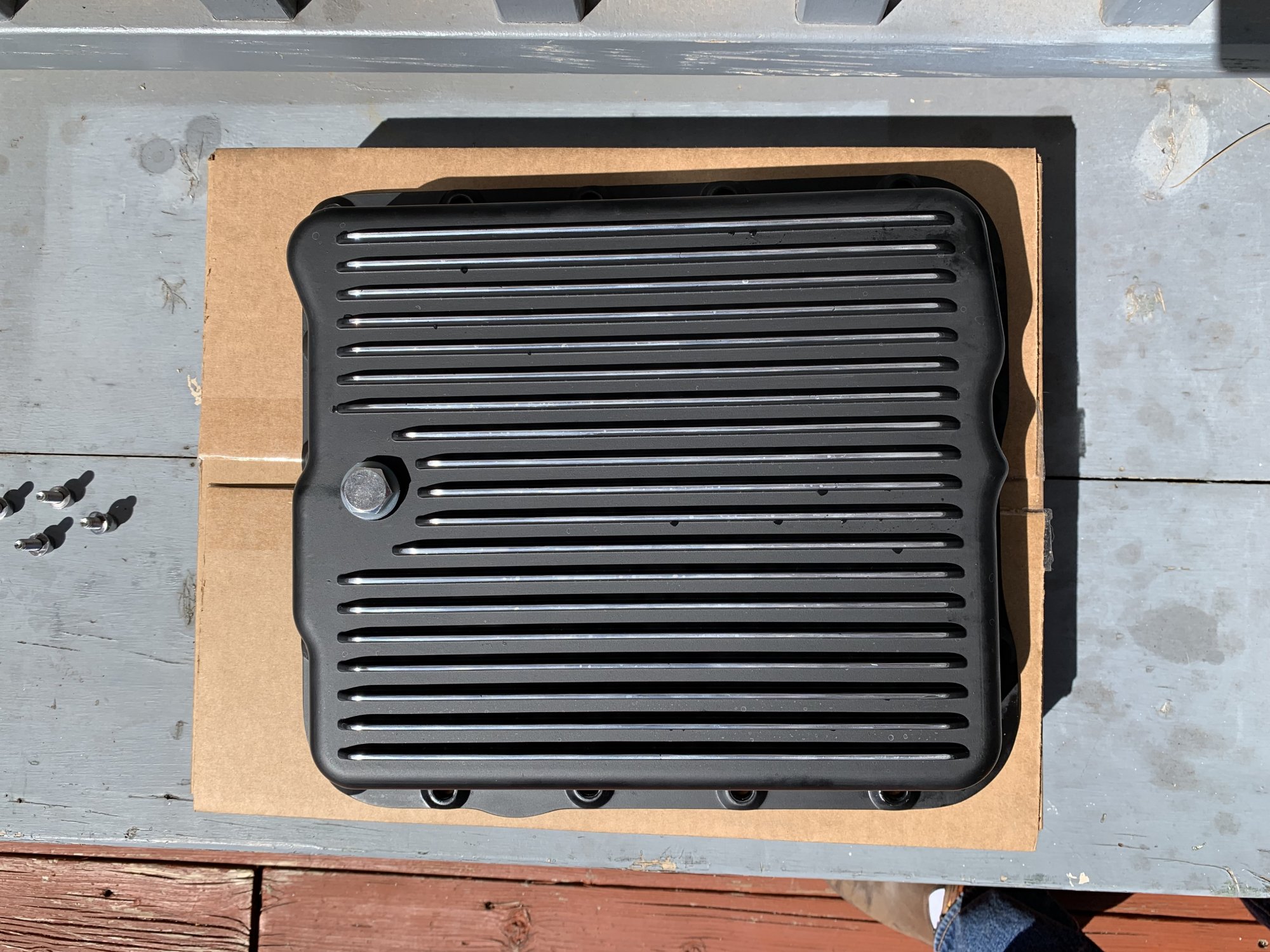

I just installed a new aluminum 2 7/8 deep pan. Now trans won’t shift into OD and eventually lights SES with p1870.

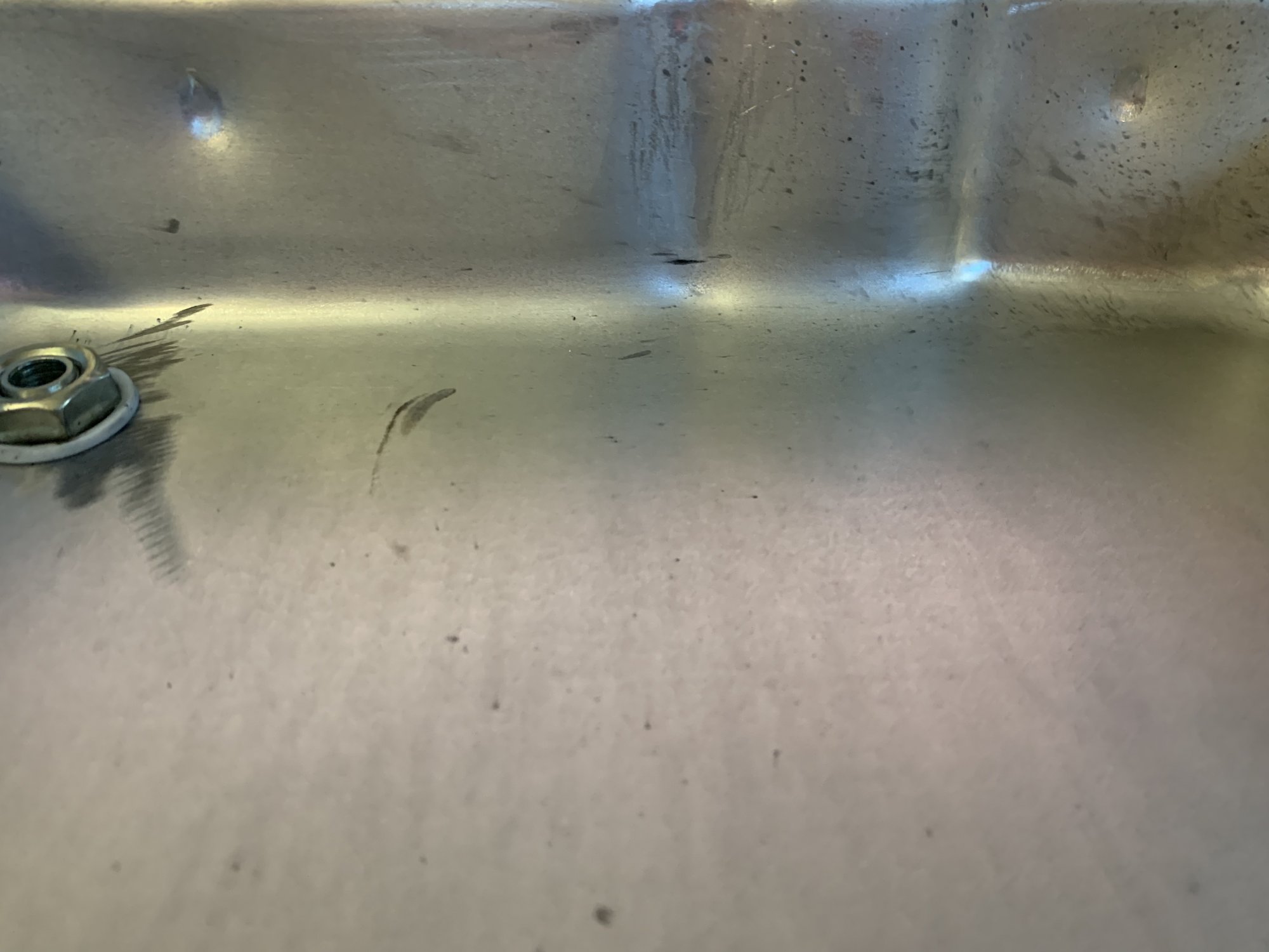

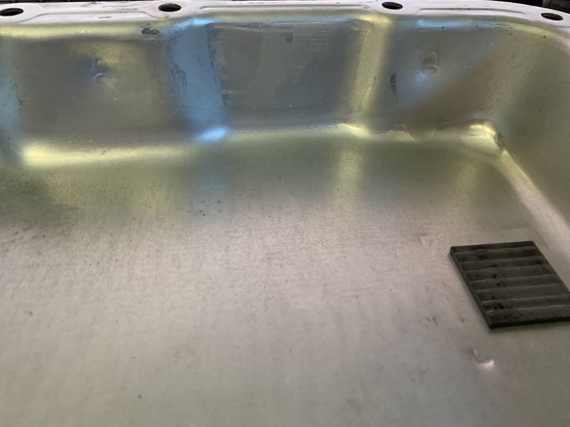

See below pics of Dents Dimple in steel pan.

The wear marks on the original pan must allow high mileage trans to shift into 4th.
I want to use my new deep finned aluminum pan but guessing I need and adjustment or valve body or complete rebuild?
Update. Truck shifts fine with original pan. I’ve noticed deep pans from tci have these small dimples like my stock pan.
Careful buying on ebay. Pan was only $53.99 and all aluminum. Also sold on amazon. I started a return will see how it goes.
Edited by 2009GMC
New pan didn’t come with extension. Old pan was 2.5” deep on inside. New aluminum pan is 2.75” deep.
I think it has to do with the design on the sides. Not designed correctly for the solenoids to operate?
