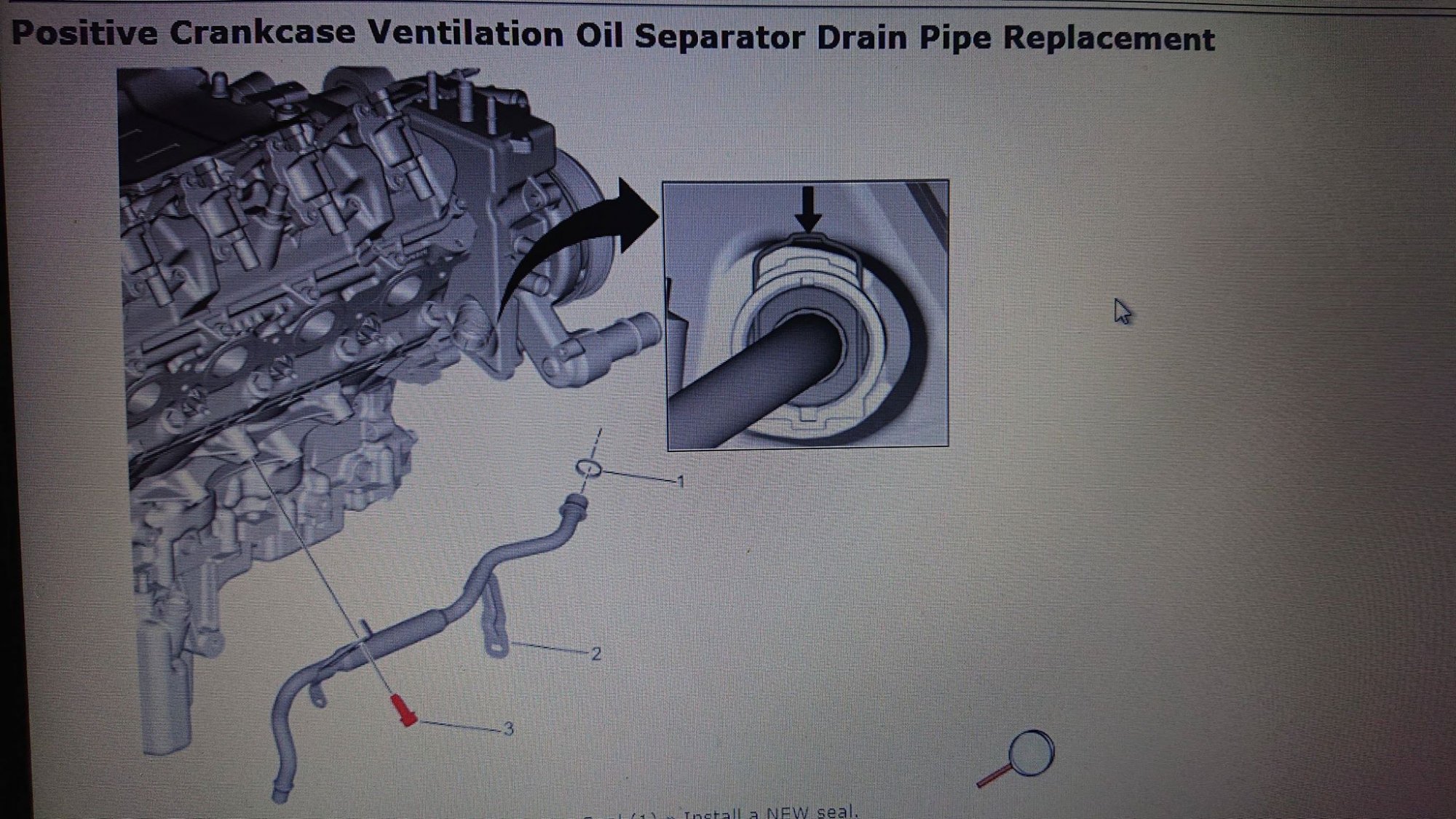

I’m looking to see if anyone knows what the part number is for the GM catch can that’s attached to the LT1 E-Rod engine (12682080).
I’m also interested in general info about how it works. Based on the description provided for this engine, it sounds like it returns whatever it catches back to the oil sump through the bank 2 valve cover.

it's bolted in between the waterpump and block, and it drain back into the oil pan
camarocatchcan.thumb.jpg.0649280ad4d57e8f85879b284c175bd8.jpgh
No matter how it’s routed, is the idea to keep the nasty stuff from being sucked back through the intake/valves? If it is being put back into the pan, I wonder if the OLM system can identify degraded oil? I assume if that stuff is being mixed back into the normal oil supply it will degrade that said oil supply faster than normal...
Perfect! That’s exactly what I was looking to see. Thank you!
Based on the location and shape of the canister, it seems it would stay quite warm, promoting evaporation of water and fuel while allowing mostly oil to return to the oil pan. I also wonder what the impact on oil life and performance are to have this returned to the pan. As long as the engine isn’t subjected to constant short trips and is run on the highway regularly, my guess is most of the fuel and water vapor will get burned off. Interesting.
