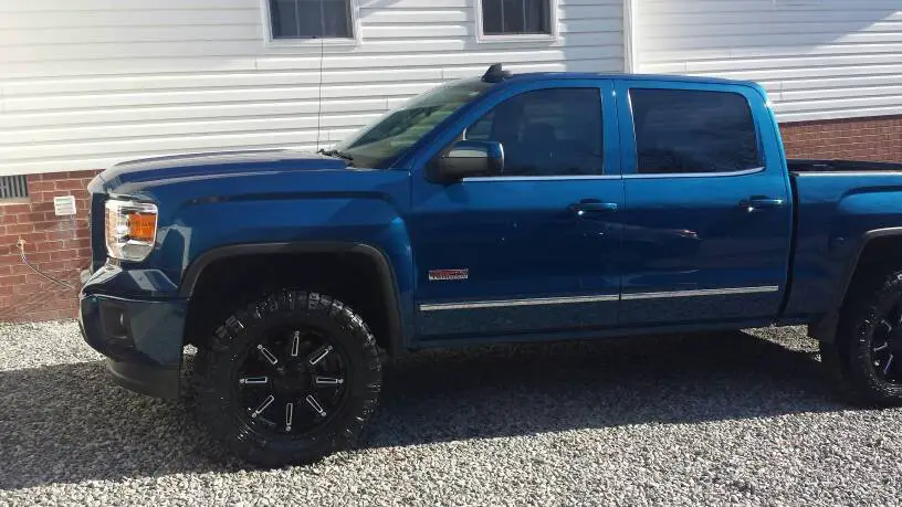

kslakelife Posted March 26, 2019 Posted March 26, 2019 Im looking at putting Nitto Ridge Grappler 295/65R20 on my 2018 Silverado 1500 Crew Long Bed. I already have a 2.5" front and 1" rear leveling kit on it. Does anyone have these on a similar rig and do you have any rubbing issues?? PLEASE HELP!! Quote
BowHunter1 Posted March 26, 2019 Posted March 26, 2019 I have this exact set-up and have no issues. Same size leveling kit with the same size ridge grapplers. I went with a zero offset wheel from Gear Alloy and they stick about 3/4 of inch out past the fender. Looks pretty good I think. I posted picture about two years ago, I don't have them anymore so maybe do a search for my user name and you might find them. I have a 2015 All Terrain in Blue Stone Metallic Quote

Ruqua Posted March 26, 2019 Posted March 26, 2019 Dang that’s a 35” tire in just a 2.5” level? Any Metal rub? Any trimming? I was wanting to go with 285/70/18s on mine but if you didn’t have a problem I should be fine. ?? Quote
BowHunter1 Posted March 26, 2019 Posted March 26, 2019 I did have to trim a few inches back on the wheel well liner. Some people zip tie them back instead of cutting them. Quote
