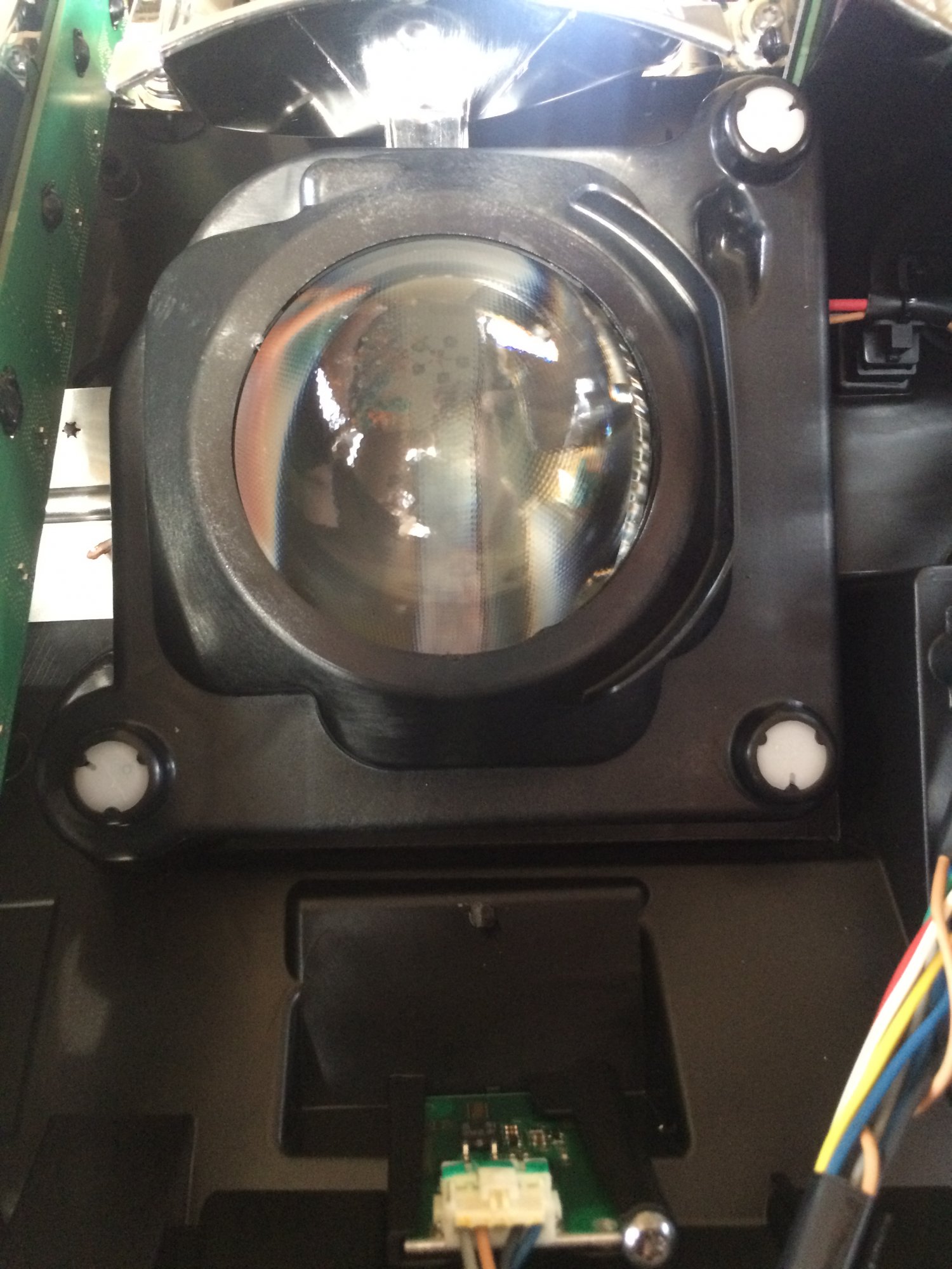

I am retrofitting my 2015 Sierra 2500hd. I have one headlight opened up (I’m swapping the corner lens as well so I opted to split open rather than cut the rear of the housing off) and I can’t figure out how to remove the plastic bracket that holds the projector. The three white circle things are what I’m trying to figure out. Any ideas? The instructions show that bracket removed so I know it comes out.
You should be able to just pop them off. It’s basically like a ball and socket. When I did a set of ram headlights, I just heated the white part up with a heat gun and that should soften them up a little and then just pop it off. You can see the ball portion in the pic I attached.
I managed to pop them off by hitting them from the backside. Thanks!
