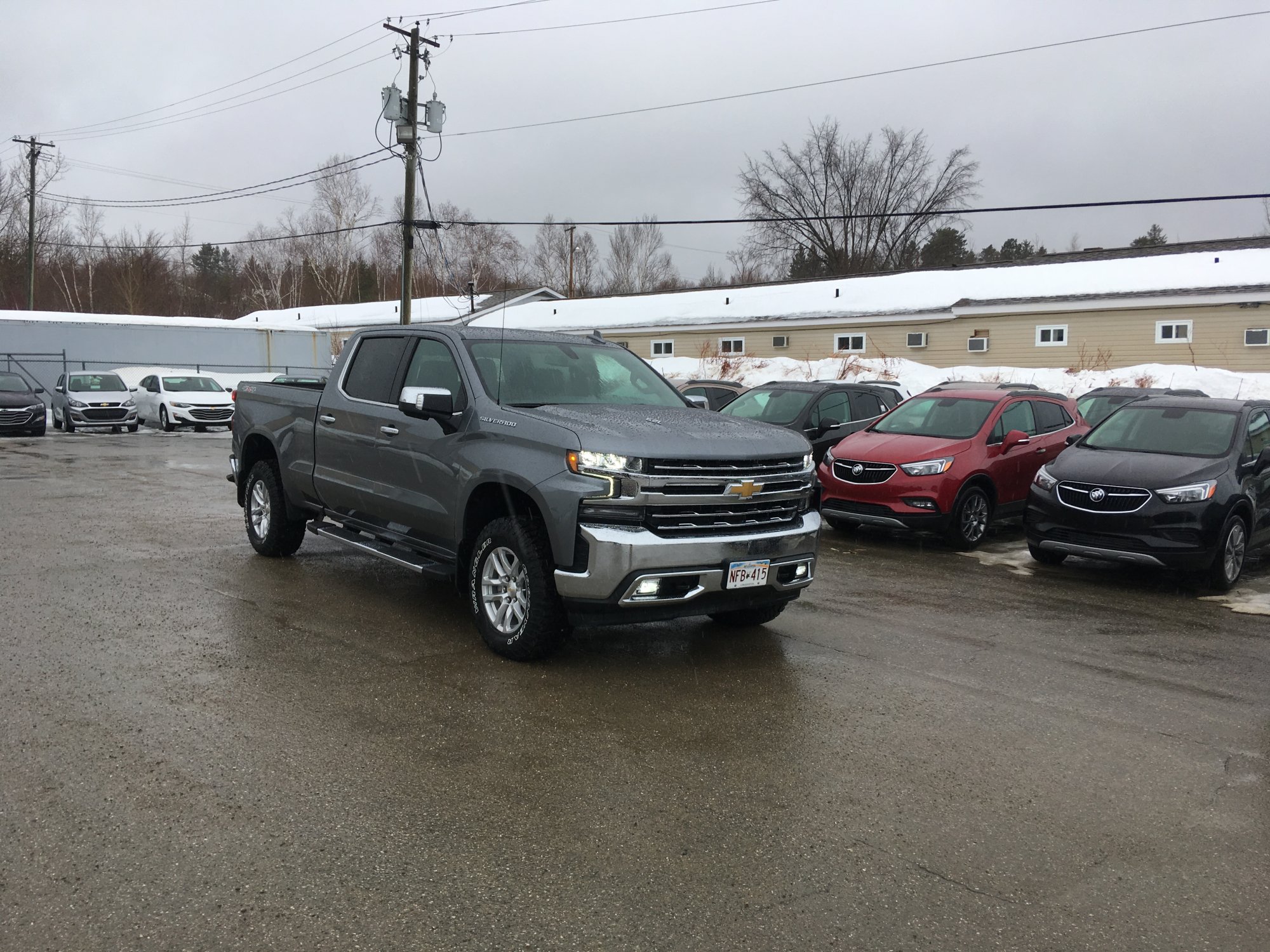

Thanks for any advice. Just got a great “truck month deal” on a 19' Shadow Grey Silverado LT Z71 5.3 8spd, leather, All-star, and convience 2 packages, 20” rims w/ Bridgestone AT. Love the solid stable ride and smooth 8spd with the 5.3. (Hope it doesn’t develop any issues like others have had). LTZ 6.2 would have been nice but went where the most value was and got everything else I wanted for a great price. Bridgestone's are pretty smooth for an AT but will replace next winter with KO2 for snow traction (had them on my 4Runner and they were amazing in snow). I might have gotten a Trailboss if I could have gotten a better deal but glad I’ve got chrome bumpers. Saved plenty of money for lift and wheels if I go that way.
New ride with April snow pack in my front yard.
  • Like 3
You have beautiful truck. I love the KO2’s. I would NOT lift it if you plan to tow much. You might consider the Bilstein 5100 shocks to level the front. If you are happy with the ride leave the rear alone. You can always change rear shocks later.

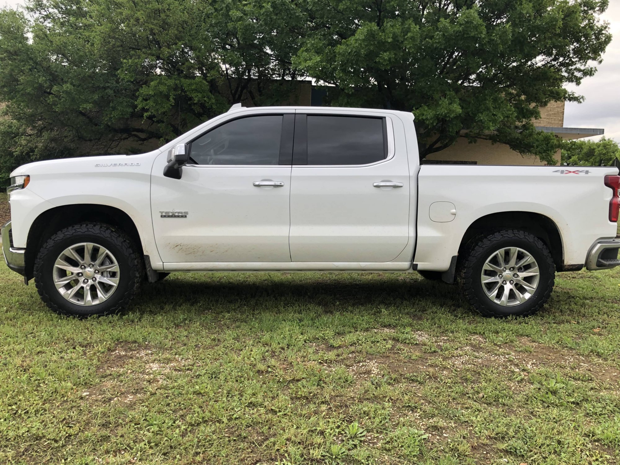

Have a 2inch level and just installed ko2 285/65r20.  No rub so far.  I will likely block the back 1in to keep a 1/2 rake.  Right now the front is 1/2 high.  I also may go with just a front 1.5inch level and leave the rear alone.

Nice. White with chrome looks so good! I decided I would keep some or all stock rake when I lift. I think it looks better and don't see any benefit to just level front. Good to know ko2 285/65r20 will fit. Was planning on stock size KO2 but that looks good. Like to see it when you're done.
