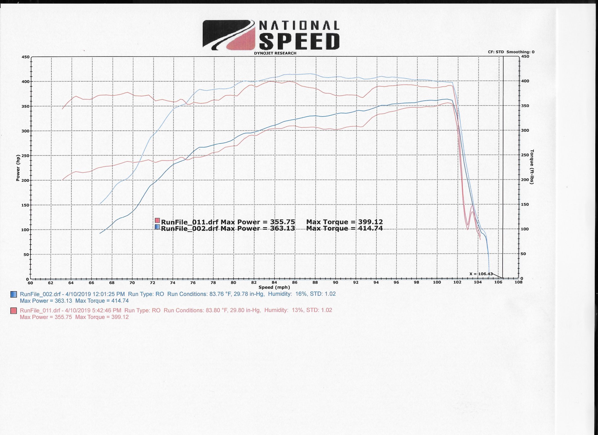

Well here it is people.  My dyno run of my 2019 Silverado with 6.2 before I installed the GM Performance intake.  Then I installed the intake and had the dealer do the flash to the truck that is part of the intake purchase.  Back to the dyno to see if what gains it might have made.
Well, to my surprise it lost HP.   The baseline was 363.13 max hp and 414.74 peak torque.  After the intake install and flash it went down to 355.75hp and 399.12 peak torque.
One thing to note is that with the 10sp transmission, they had a hard time keeping it in 6th gear when they hit the throttle.  It wanted to downshift even though they were using manual mode. Also another issue was it was reaching the speed limit of 106mph and cutting off with in seconds of going WOT.  To bad there isn't anyway of turning off the speedlimiter on these.
They did  10 pulls trying to get a solid run.  The guy really was trying and wanted to keep going but there were other vehicles slotted to use the dyno so he ran out of time.
So it seems that there isn't a gain, at least for me putting on the GM Performance intake.  Bummer really.  Sounds nice but stinks that it lost power and torque.
Well you gained 200 ft lbs of torque at 67 MPH according to this chart  LOL
I wouldn't read into this at all as you can see the charts are not comparable at all.
You're going to have a loss if you're only trying to gain from one end. CAI needs exhaust to go with it. Forcing more air through the same exit will result in your exact results every time. Put an exhaust on and see the difference. I wouldn't expect much for gains, but you'll at least get back to stock. Throw some bigger injectors in there and now your talking. It's just money, right?
You said you did a flash, If you were to go drive the truck around prior to Dyno, would the truck relearn everything and possibly pull a better run?

I would think it needs to relearn.  The fact that I disconnected the battery, per the GM instructions on installation of the CAI, It might have reset the ECM and have to relearn all over again.  So that is why, if I can make it happen in  a few weeks head back down for another pull to see if anything changes.
