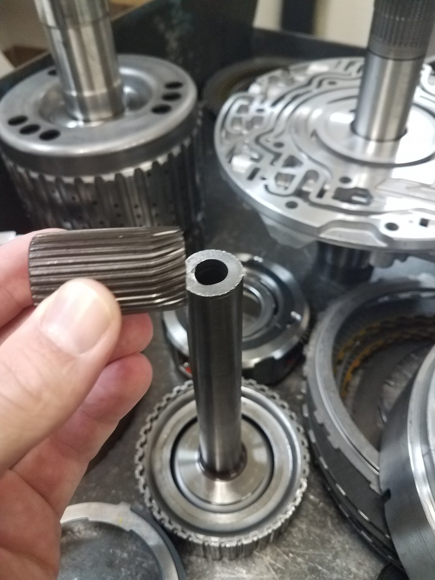

Just wanted to post on here, as I have seen no less than a thousand posts with questions about the 6L80E, specifically about the power threshold of a stock unit. I have a 2014 GMC Sierra SLT Crew Cab Standard Bed stock 3.42 gears stock drive shaft stock 20" rims/tires 6.2L fully forged top/bottom end "Armageddon Twin Nagasaki's" (GT3582R's) e-boost 2 gauge Z06/LT4 fuel system 365lph in-tank Armageddon fuel pump QTP exhaust cut-outs and laid down 965rwhp/850 rwtq on a mustang dyno with 18psi on 116 race fuel (cut-outs open). I say all of this because the stock transmission detonated the 4-5-6 shaft (intermediate hub) near the splines. I took it to a "race shop" that said they would upgrade as much as they could; and was told at the time, there were limited aftermarket parts available for the 6L80E. This was mid 2018 with less than 10K miles on the truck and about 500 miles on the engine/turbo build and I discovered that was not entirely true. I drove the truck after their work,  with "spirited road driving" while the roads were wet no less. Long story short; they f'd me and I detonated the 4-5-6 stock intermediate shaft again within 100 miles and no traction at all. They apparently replaced all parts that were broken with stock parts! Moving on, I took my truck to a different shop and researched my a** off and found PATC Transmissions. I had a warm and fuzzy after speaking with them and ordered the Phoenix Level 4 Master Rebuild kit among a few other minor accoutrements and re-tuning of my TCM by Mike from Century Automotive. It is now APR 2019 and I am about 1 1/2 weeks away from having the my billet planetary gear mailed to me; for the new, more reputable shop in my area to install all of this PATC bada**ery. If anyone is truly interested, I will post new info once I put the new Phoenix Master Rebuild kit through the ringer with the full weight/horsepower/torque of my particular application...I hope this helps if there are some lost souls out there that may be headed down the same long. hard. road. of a "full send" like myself! Please post if you have questions/comments/concerns; as I have "been there done that and forgot the t-shirt" with the L86/6L80E so far.

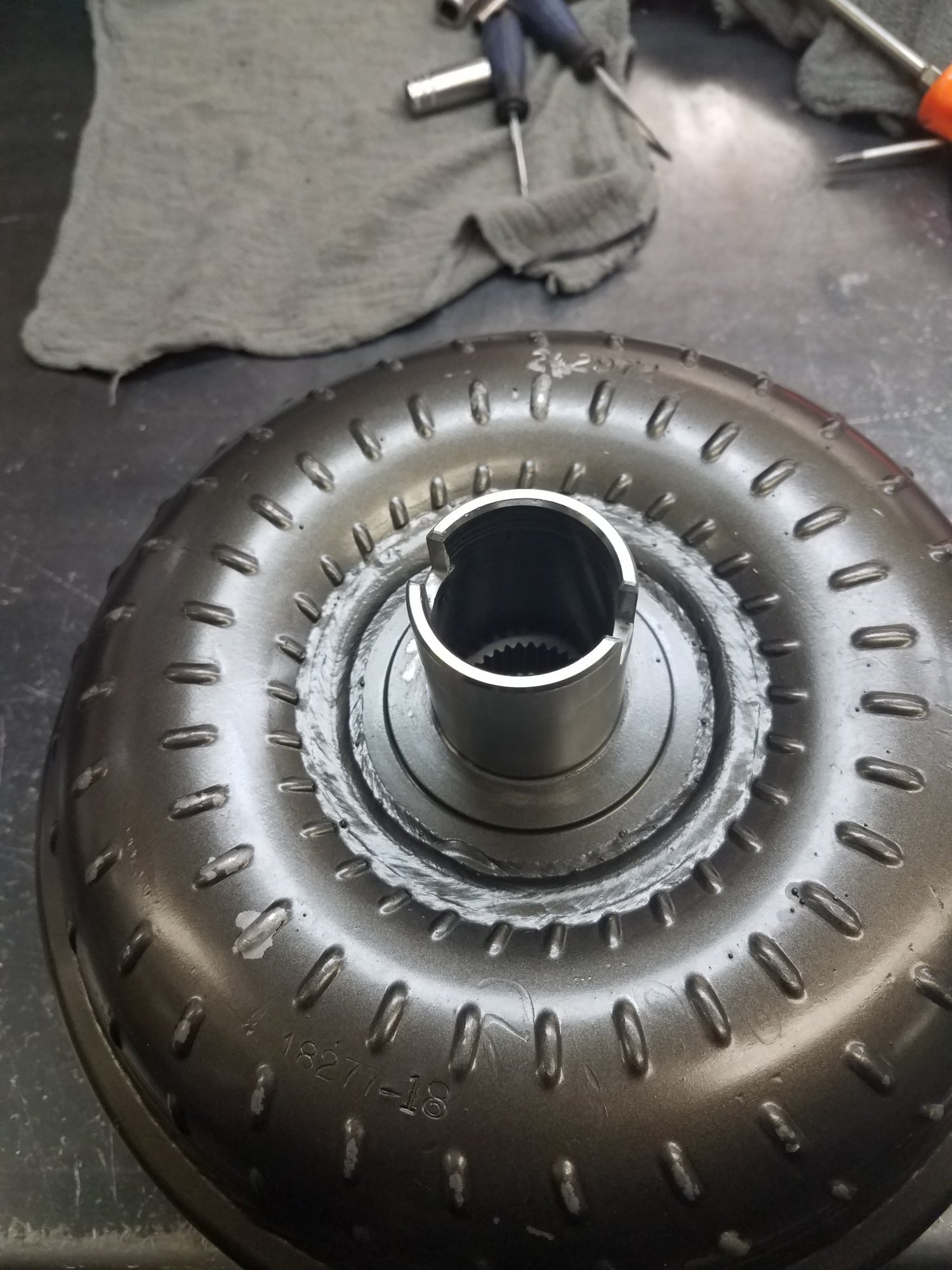

So I will be getting a new trans for free but started to think ahead. I want the new converter installed for sure and may as well order the stage 3 trans. Retail is $4500 I will can and see what my cost is.
1SLOW1500- That sucks man! If you need a converter, I actually have a TCI 2800 stall that I purchased the first time I had the trans "rebuilt". It only has about 100 miles on it and it is the bolt together option, not welded. Let me know if you are interested, as you could at least look inside of it and upgrade/change some internals in it if you wanted to.
I may need that. What size is it and single or dual. Have part number. Just PM me.
**Update**
Currently just waiting on the billet planet from PATC to be shipped to me, and this may not be news to some of you, but my trans builder is going to use a new factory 6L90 "hub" inside my 6L80; which is supposed to be stronger and accept 1 more superglide clutch which comes in the PATC phoenix kit.
This is the photo of the grenaded 4-5-6 intermediate shaft. (The 6L90 "hub" pictured in the rear, left side of the photo).
