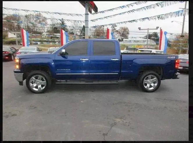

Do you have any pictures of the truck, such as from the dealership? Do you know for sure if it’s a crew cab or a double cab? Crew cab is the big cabin with large backseat room, while double cab is still four doors but a smaller backseat than a crew cab.
Crew cab trucks usually have the shorter 5ft 8in bed, while the double cabs usually have the standard (6.5ft) bed. However, it is possible a crew cab can have the longer 6.5ft bed, but it’s somewhat rare. If you have a picture of the truck from the dealership, you can easily tell based on where the fuel door is on the bed.
Look at where the fuel door is located in contrast with the fender lines on the bed of the truck. A standard bed will have the fuel door located between the cab/start of bed and the fender line on the bed. While a short bed will have the fuel door pushed closer to the rear wheel located on the actual rear fender. If that makes any sense, it’s a easy way to tell the difference.

So this would be a Short Bed (5ft 8in) ?
Because the VIN Decoder says it`s a Standard Bed. (6.5ft)
That is a standard bed (6.5ft).
Thanks a lot, i searched for some pictures and now i see it to.
