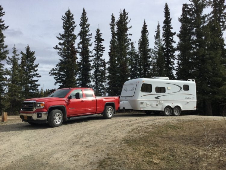

I installed a new pump last winter after reading about possible problems. Bought the pump from Amazon $121.00 installed it in about 2 hours did remove the little steering shaft much easer access. Added heated steering wheel while I was working on the truck nice. I work very slow a good mechanic could do it in 1 hour. My truck is a14 SLE with 45000 miles very happy with it tow 21ft trailer perfect. Did get the letter yesterday applied for refund for the pump. Will be buying a new 2020 next year.
