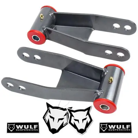

What do you guys think about lowering the rear with these shackles?
https://wulfsuspensions.com/collections/chevrolet-gmc/products/2004-2014-ford-f150-rear-shackle-leveling-lift-kit
I installed those on my truck they worked fine. If you can take out the lifting block I would do that first though. My truck did not have a spacer. I'm assuming just the trail boss models do because the front is lifted.
