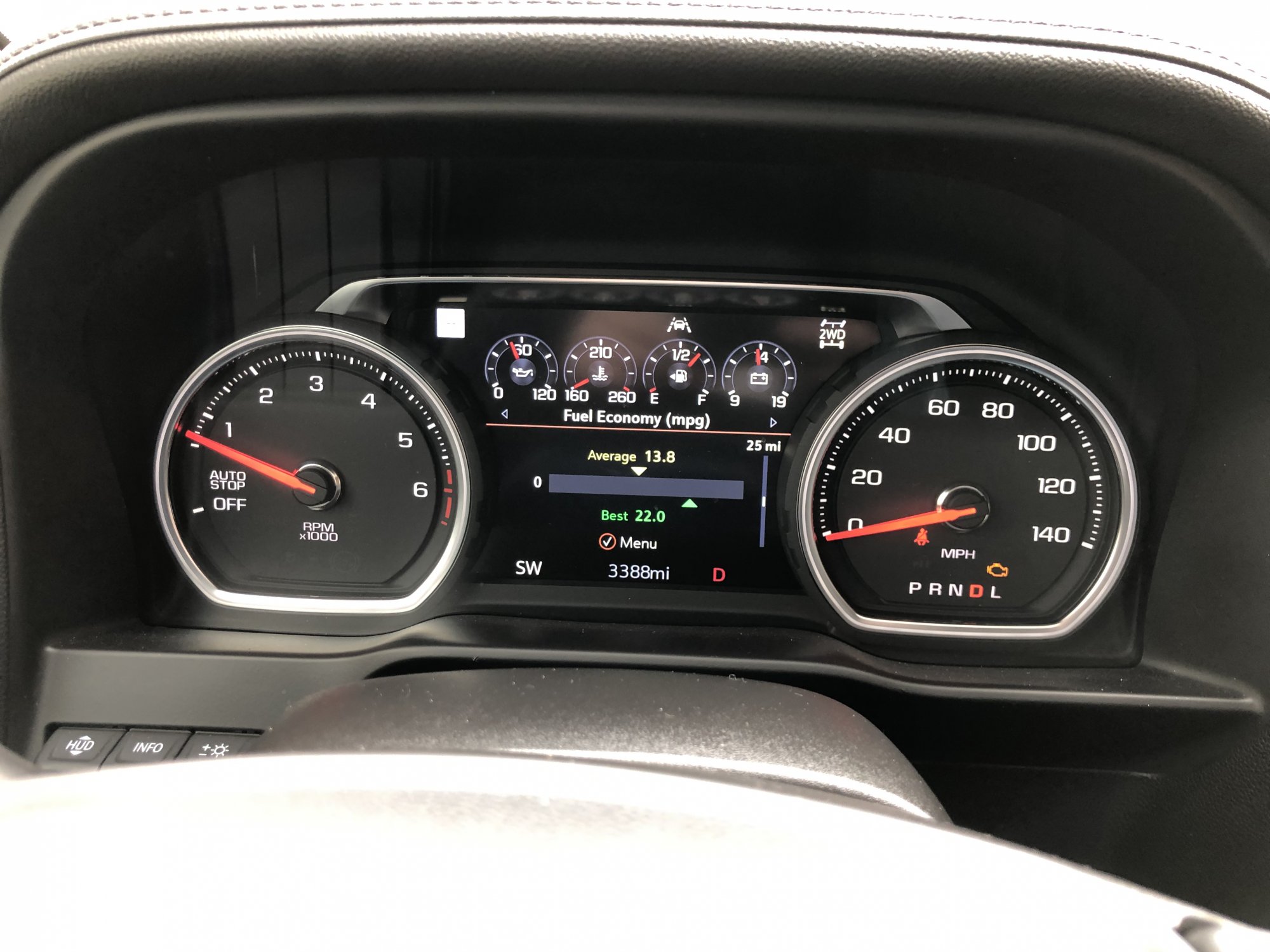

Well, I knew I was in for something when my remote start didn’t work this morning... Had a check engine light on. Busted out my scanner and found a P1005 code.
Found TSB for it here:
https://gm.oemdtc.com/10285/ses-mil-dtc-p1005-2019-chevrolet-silverado-gmc-sierra-1500
Unless the TSB has been updated recently, it looks like all they do is clear it anyway, so I just cleared it myself. Dealer is 30 minutes each way and I don’t have the time to waste if there’s no real problem or fix for it.
So far so good. Just wondering if anyone else has had this issue before, and what your experience was with it. I don’t really remember seeing it mentioned on the forum at all...
