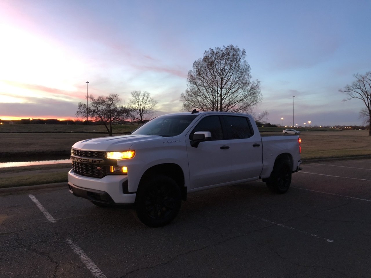

2 inch level with ProComp 42 wheels on 29560R20 KO2’s. Had to do a little trimming.
What offset are your wheels and what all did you have to trim? Looking at this tire size with a 0 offset and 9” wheel for my AT4
Looks good! I’m wanting some new tires really bad. How does the ride comfort for those E load range tires compare to the softer factory tires? Thanks!
