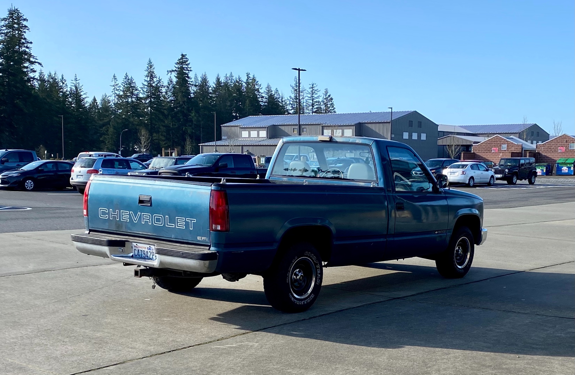

Hey! Thanks for your input. I had the same idea myself. The thing I can’t wrap my head around is that the compressor should be switching on and off intermittently. If I wired in a switch to turn the compressor on/off when I wanted AC, wouldn’t there be no way for the compressor to turn itself on/off as it should? Or does the compressor have a sensor that activates/deactivates by pressure? I’m not sure how it works, but that is my big question. As for my progress, I haven’t made any progress on the AC system yet. Im about to start getting into it again though because I want to see it done. However, this is what the truck looks like now. It was dirty in this pic but I recently gave it a comet wash to get it ready for sanding and painting here in the future.
