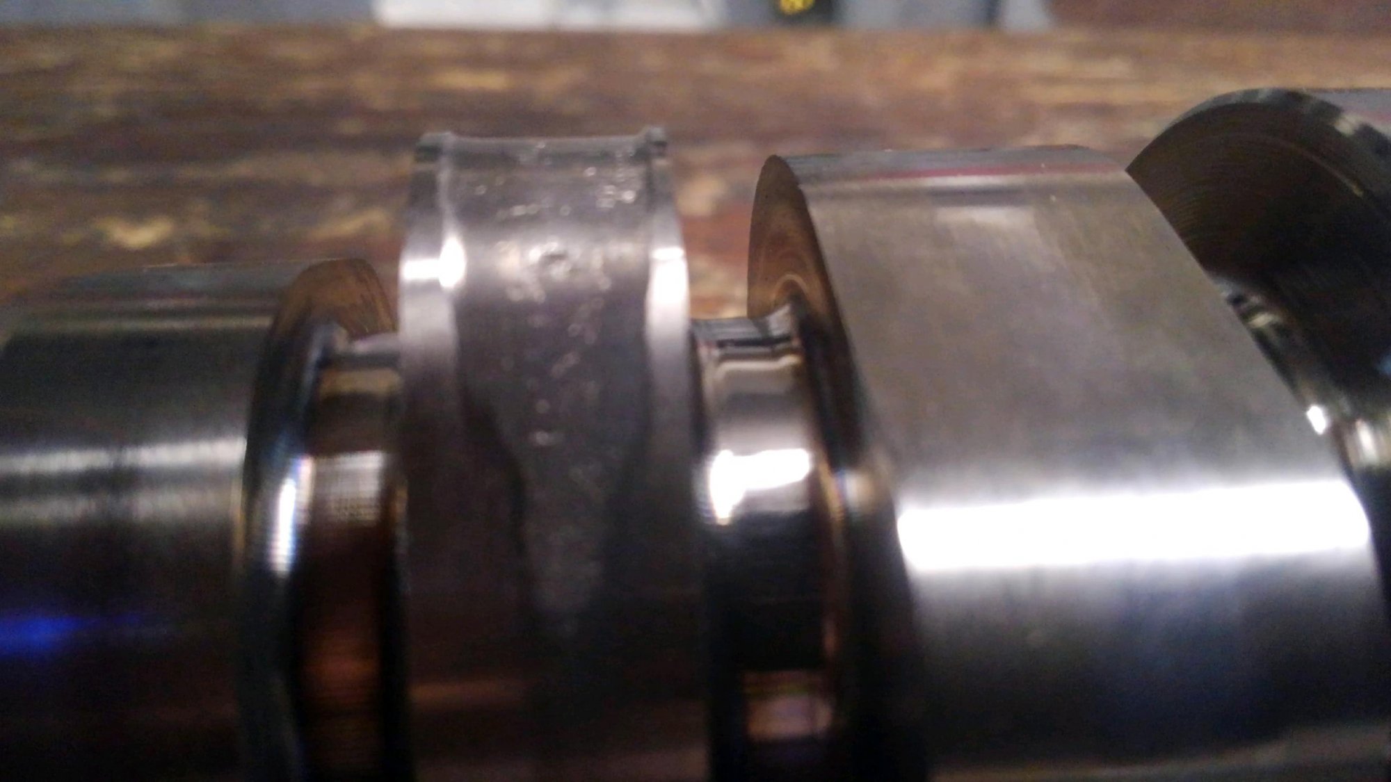

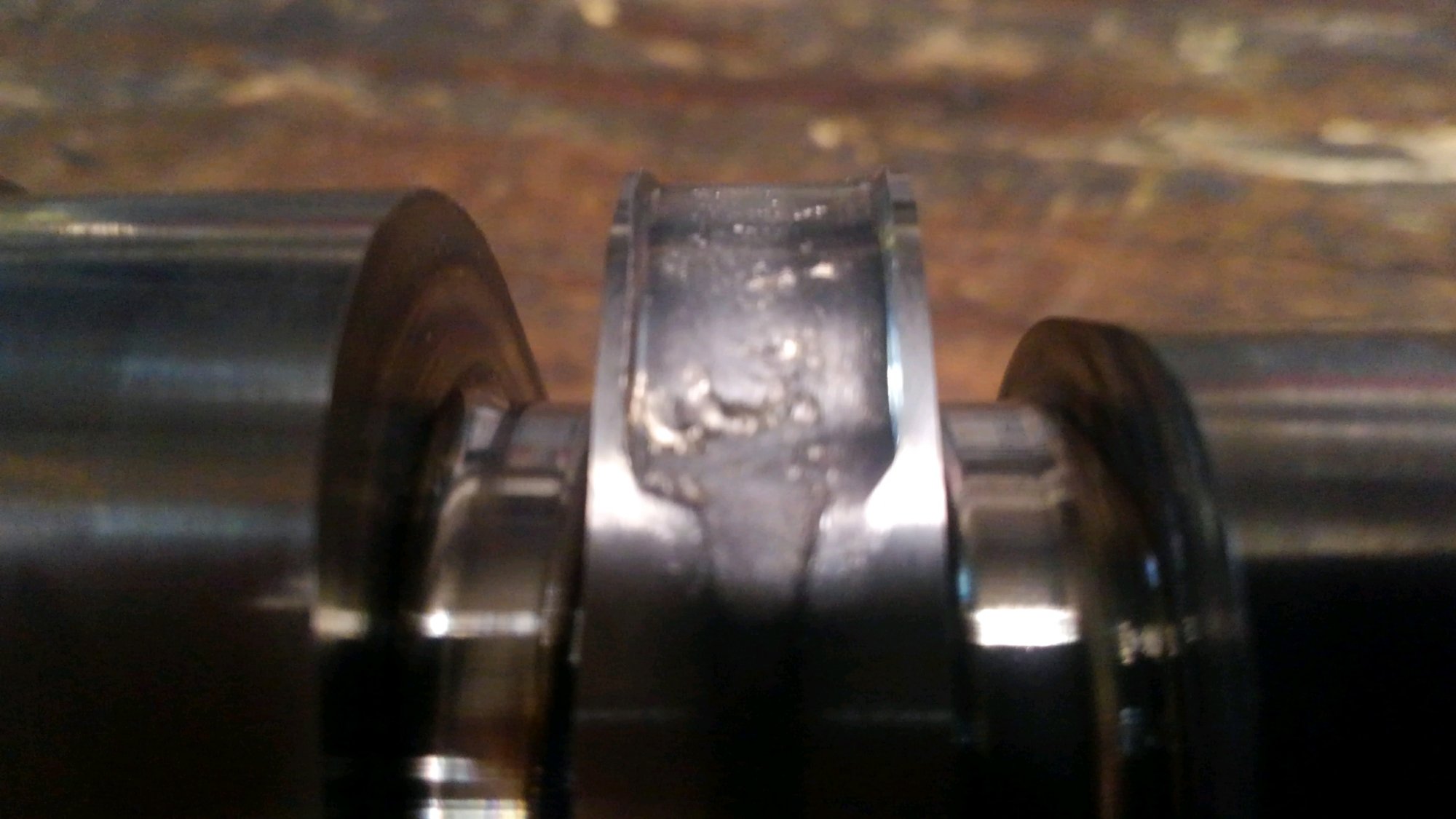

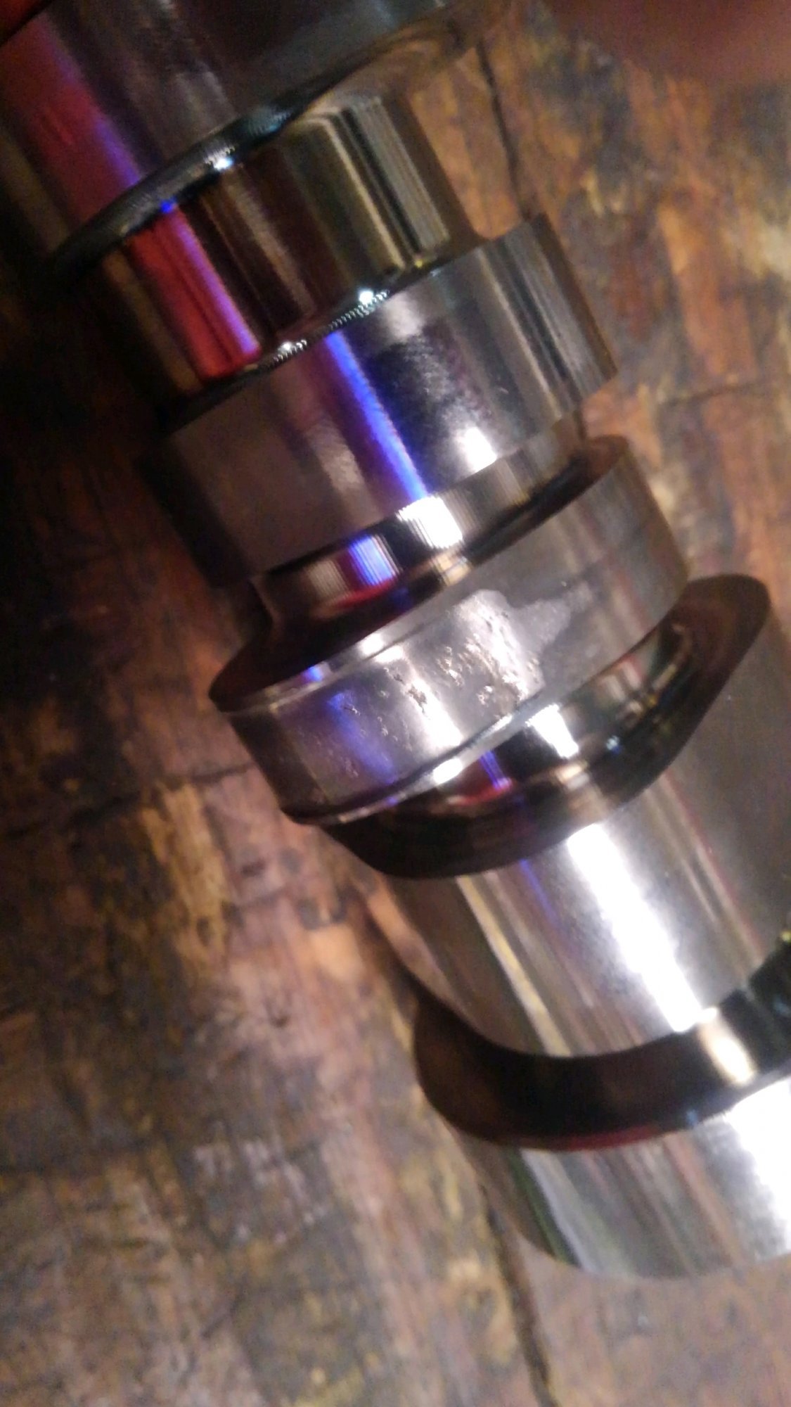

Reading mixed information about our stock crankshafts. Some say it’s forged steel and one other place says they are cast.
Either way, is it possible for the camshaft material that is now assumed to be in my oil (see pics below) to destroy my crankshaft?

IF the collapsible lifters for 4 cylinders fail...for the V4 mode...it eats your CAM.
GM bulletin causes, plugged filter in the intake manifold for the hydraulic solenoid that shuts down 4 cylinders so those lifters COLLAPSE and won’t pump back up. It does have a TSB.
IF...you are this deep into it. Do NOT install collapsible lifters so history can repeat itself. Use NON Collapsible lifters so V4 mode can never screw you over again.
Cheaper alternative but probably too late...market is FLOODED with GM L83 5.3 motors with less than 20,000 miles where you coulda electronically disabled V4...those motors are goin for less than $2k.
Do NOT let your motor EVER go to V4 mode. You aint the first chewed up cam I have seen.
BtW..yer pictures are CAMS...NOTTA crank.

LOL.  I know... the pictures I attached are of my camshaft.  Not my crankshaft.
