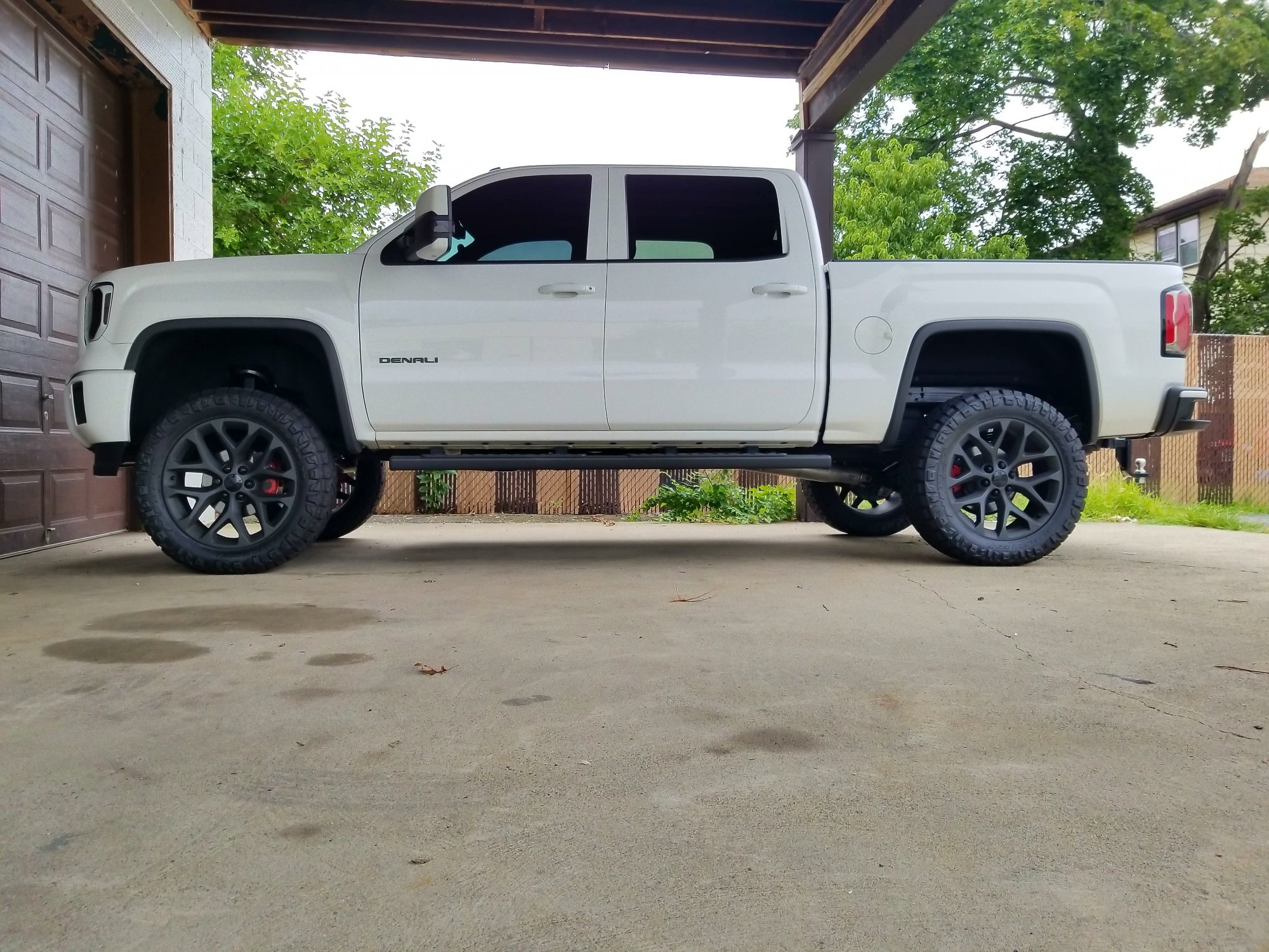

I have a 2014 6.2L 6L80 transmission  Sierra Denali that has stock 3.42 gearing now.  I plan on a power adder very soon either turbo or supercharger and was debating which gear ratio to go with.  I am running 35's now on a 6.5" lift but adding another 1.5" lift very soon.  I do tow with the truck and don't care about fuel mileage just don't want to over gear the truck.  Just wondering who has a similar setup and how they like it.
So, since you are sitting 6.5" higher, I assume you a running the Zone lift?  What are you adding to gain another 1.5"?
