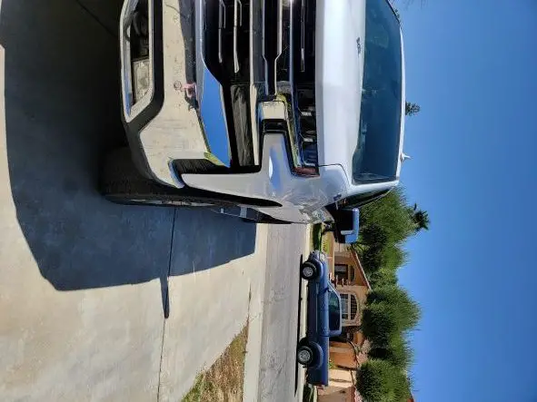

Looking to add spacers since the wheels rub slightly on caliper. It looks like 1.5”will need studs grinded and I dint want to do that so going 2”. Will also have fender flares installed. Just don’t want tires to stick out too much. Thoughts??

This truck is beautifullll.    What rims are those?

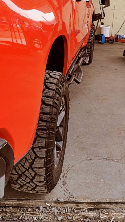

2021 Silverado Trail Boss LT.
2" wheel spacers on stock wheel/tires. Next week I'm installing 2" leveling + Fox IFP 2" Shocks  + Camburg Upper Control Arms and 35x12,5R18 Maxxis Razr MT on stock wheel.

I really like the offset !
What size tires are you running ?
Those in the pics are OEM tires. Tomorrow i'm installing 35x12,5R18 Maxxis Razr MT on stock wheel with 2" leveling + Fox IFP 2" Shocks + Camburg Upper Control Arms.
I will post pics on the weekend.

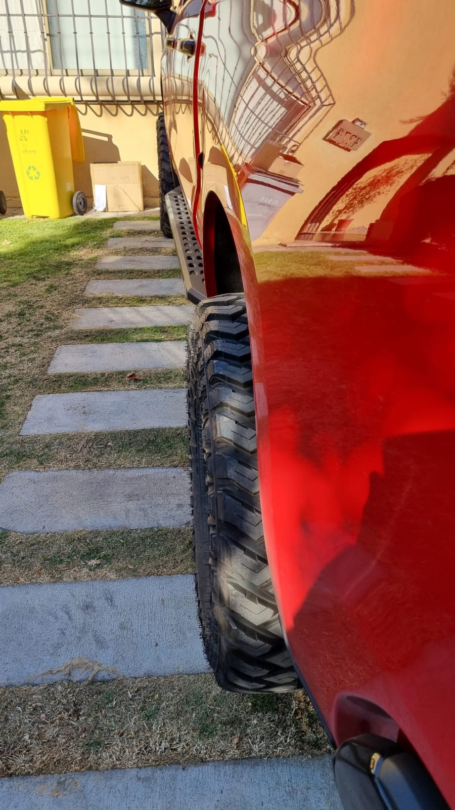

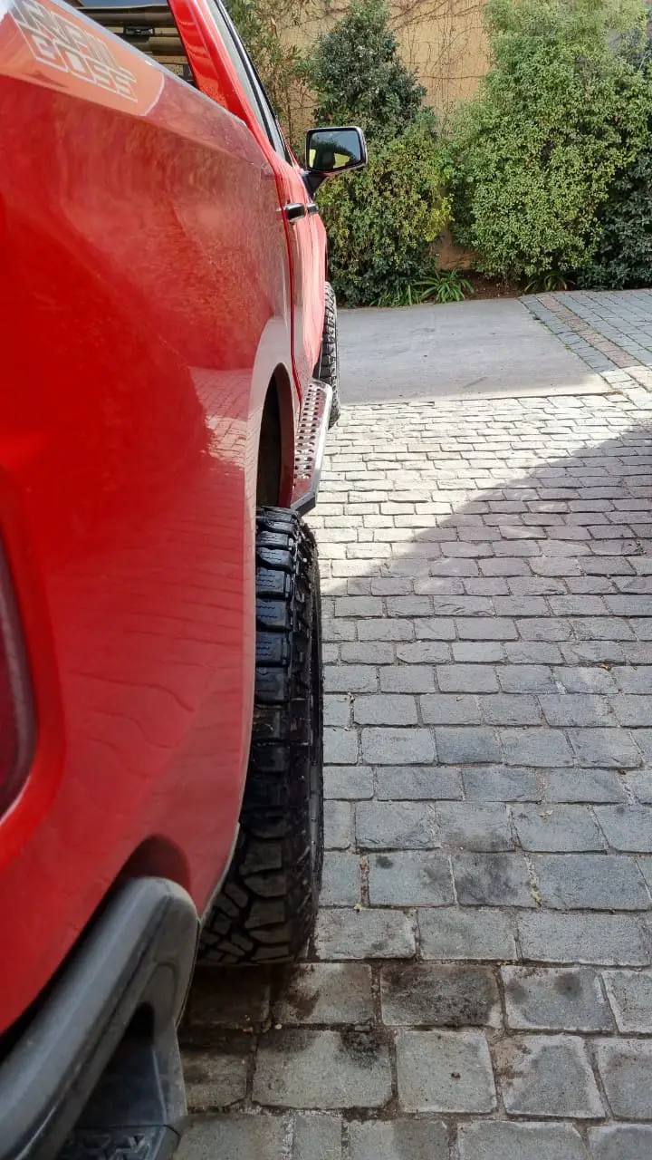

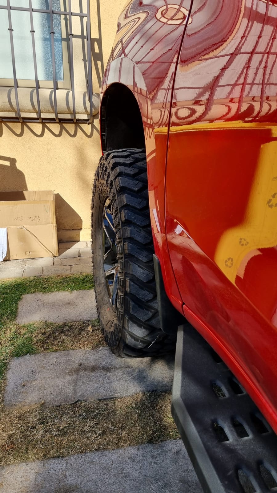

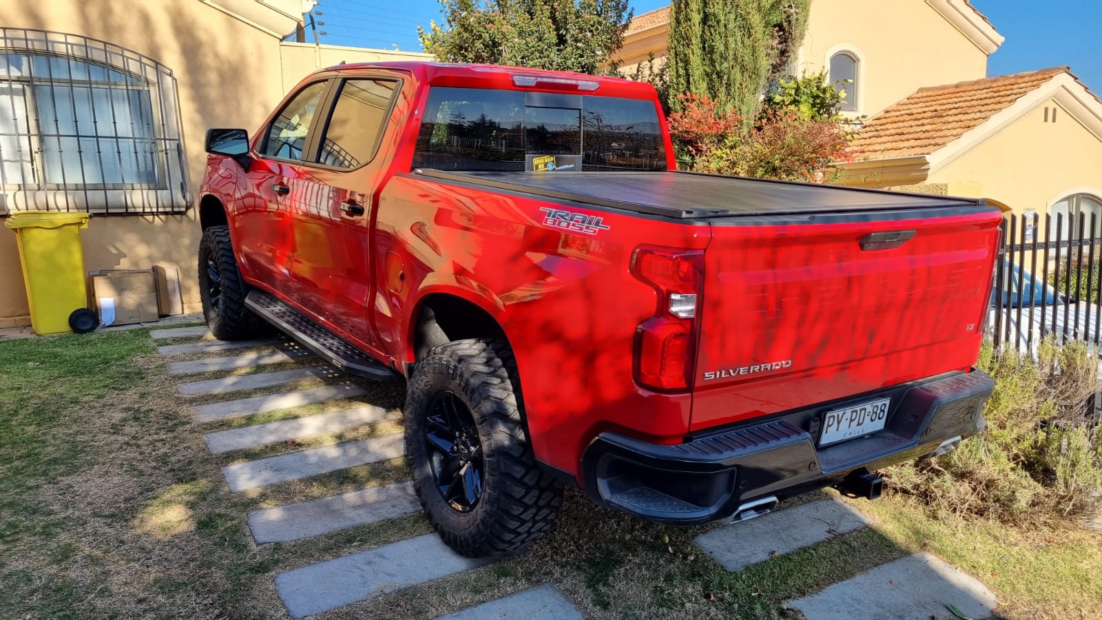

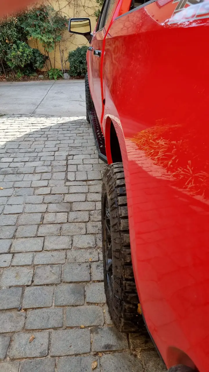

Here is the final setup:
- 35x12,5R18 Maxxis Razr MT on stock wheel
- 2" Wheel spacers.
- 2" Body Armor leveling kit
- Fox IFP 2" Shocks
- Camburg Upper Control Arms.
- Trimmed mud flaps (Needs more trimming, still rubbing in full turn and flexing)195321712_WhatsAppImage2021-07-10at9_42.14PM(4).thumb.jpeg.87b031b77656afa015658c8d8692ab5d.jpeg

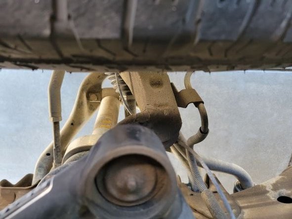

Long time getting around to this, but my stock tires are due to be replaced soon so thought I'd install some spacers so I could keep my stock LTZ Wheels. 5-10k more miles and I'll be putting on my 305/55R20 Mud tires from my 2014 Silverado. Photos really don't due justice to the difference in the look, but you can see how close I was to my uca's prior to the spacers, max was about 1/4".
2019 LTZ/Z71 Silverado w/35k miles
6.2L with the Chevrolet Performance Intake & Exhaust installed from factory
Readylift 4" SST Lift
Stock LTZ Wheels w/ stock 275/60R20's
Supreme Suspensions 1.5" hub centric spacers
