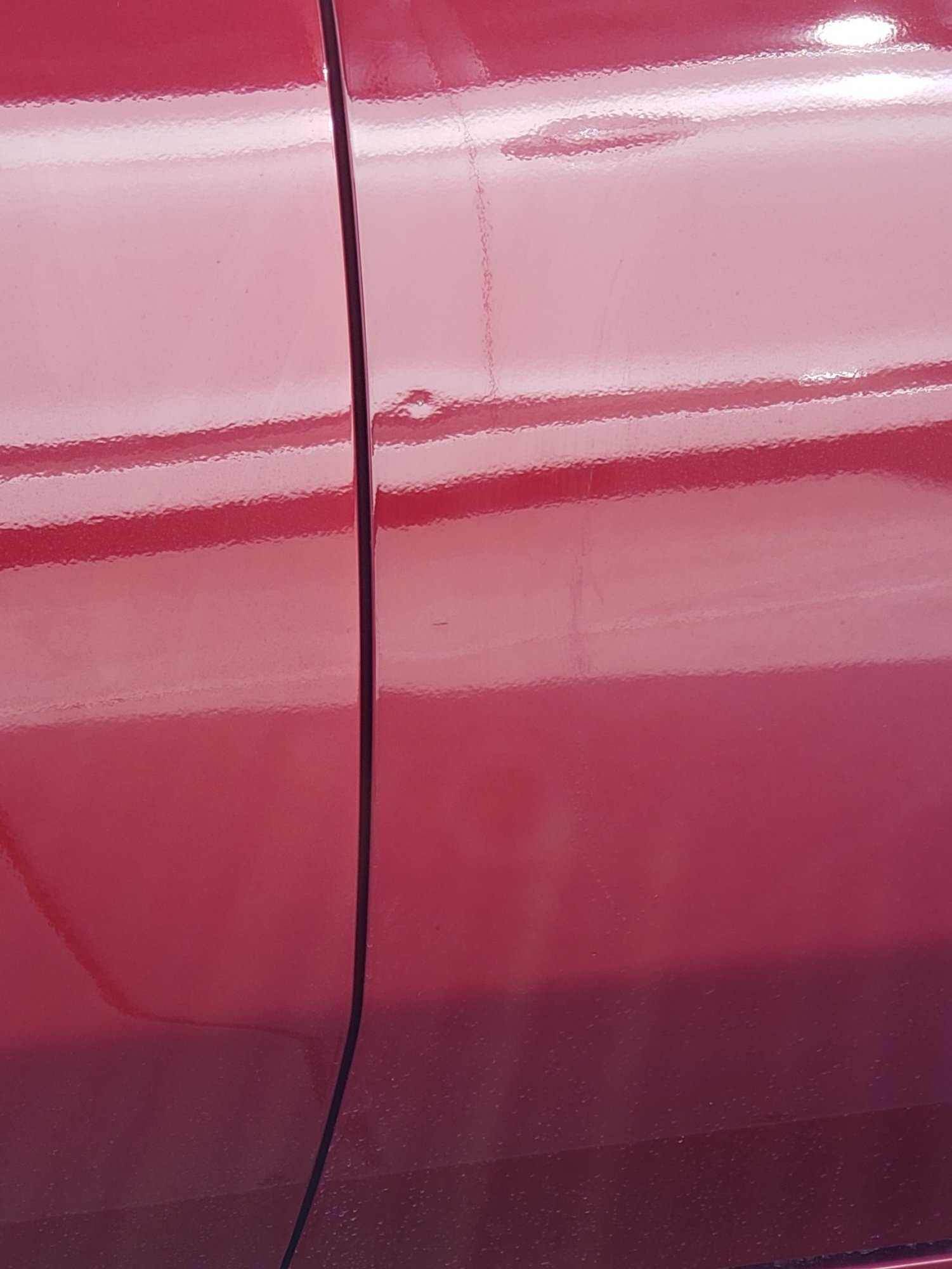

Trucks in but showed up with 2 door dings with paint damage and some clearcoat scuffs on front fender, Been raining so truck dirty hard to see scuffs till it gets washed but attaching the dings. They are going to fix dings and paint both passengers doors to blend it right. Going to install my up fitter switches no charge do to issue. Drove to Vegas and with 18  rims Michelins no shimmy or vibration issue. The heavy duty springs I was worried about when saw they added to order is a non issue truck road fine no harshness especially when on the crappy Vegas freeway near old Downtown area. So am happy overall so far other then paint damage. Side note wish you can see what gear you are in like the Ford I traded in.
