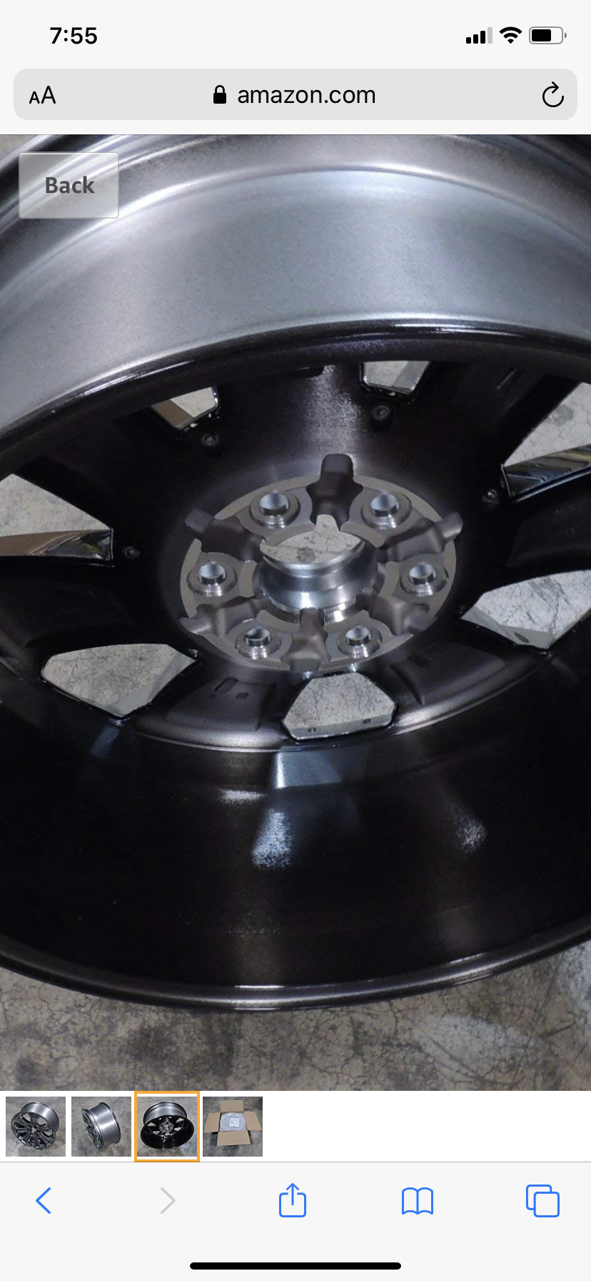

Hey guys! I am getting tired of my 33s rubbing the UCA and sway bar at full lock forward and reverse. I noticed 4wheel parts had a set of 1.25" spacers exactly like the hub centric BORA ones . I picked them up and was hoping my factory wheels had "pockets" on the back to allow for no cutting of the factory studs. I temp installed the spacer and the wheel back on but it didn't seem like the lugs were coming through the wheel nearly as far as they should. I have searched the forum and haven't seen anyone state they have used them with these type of wheels. I have noticed some stating they have used 1" spacers with the factory 20" "snowflake" wheels though. Attached is a picture of the backside of the wheel and to me it doesn't seem like it would be an issue since in between each lug hole is a gap for the factory studs to sit in. So with that, to me, I should be able to get the full depth of the lug nut without cutting the factory studs/tips off. Can anyone chime in please? I really don't want to buy new rims on this truck.

As long as your factory studs are 1.25 or less then it should bolt up without any cutting.
