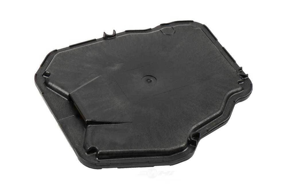

Any idea when they will update the owners manuals on the filter?
And is it truly a filter, or just a "screen"?
Can you provide a picture?

I do not have an answer yet, but i will post pictures of old filter whenever I get it serviced, I'll make sure to ask them to save it.
Auto Trans Filter Kit
Part Number:  TF922
Product Notes:
All; FILTER REPLACEMENT NOT Reqd WHEN FOLLOWING TSB"S: TSB 16-NA-175 OR 18-NA-177; VIN: J, Auto Trans, Eng Code: L86, 8L90, 8 Speed Trans, Transmission*
Per Vehicle: 1; Years: 2015-2018

Thanks for the picture, but really still have no idea what the heck it is, do you now if that is the top or bottom of it?
