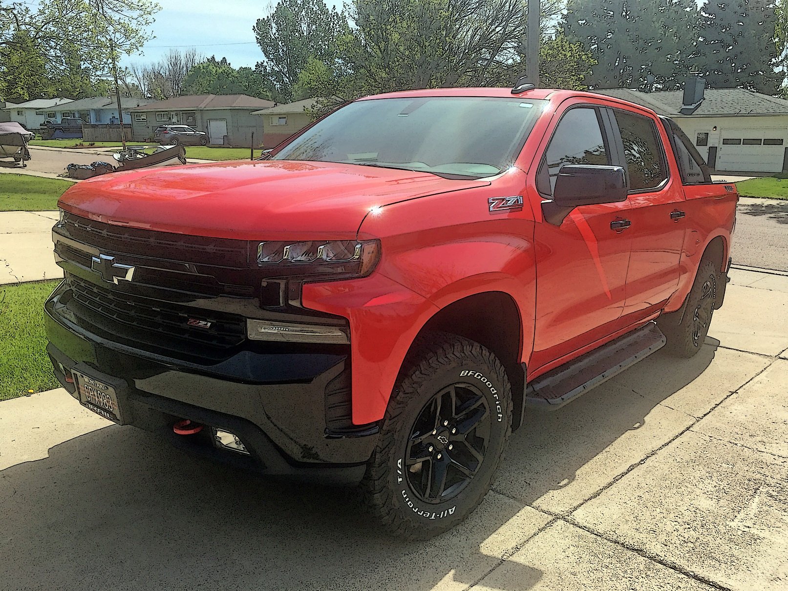

I noticed the hum/whine right away and attributed it to the tires.  They're the most obnoxious around 25 - 35 mph, but seem to quiet down at highway speeds.  I also noticed they do fantastic in snow and ice, but I've read once the siping wears off after 20K - 30K miles they are basically mud terrain tires and don't do as well.  I imagine they'll get more and more noisy as they wear too.  I went ahead and replaced them at 8000 miles with 33" BF Goodrich KO2's and they are significantly quieter (but still hum a bit) and fill the wheel well better.  I was able to give my son in law the Duratracs, so it worked out fine for me.

I like the look with the BFG KO2s.  I'm an old school white letters out guy.
