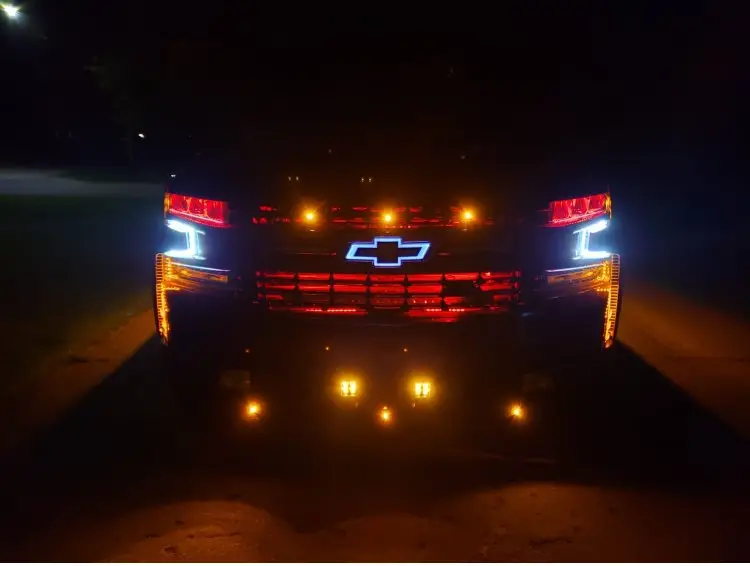

On 11/27/2021 at 7:23 PM, Chevy8088 said:
Ran it to the side marker fuse so they come on when they come on.

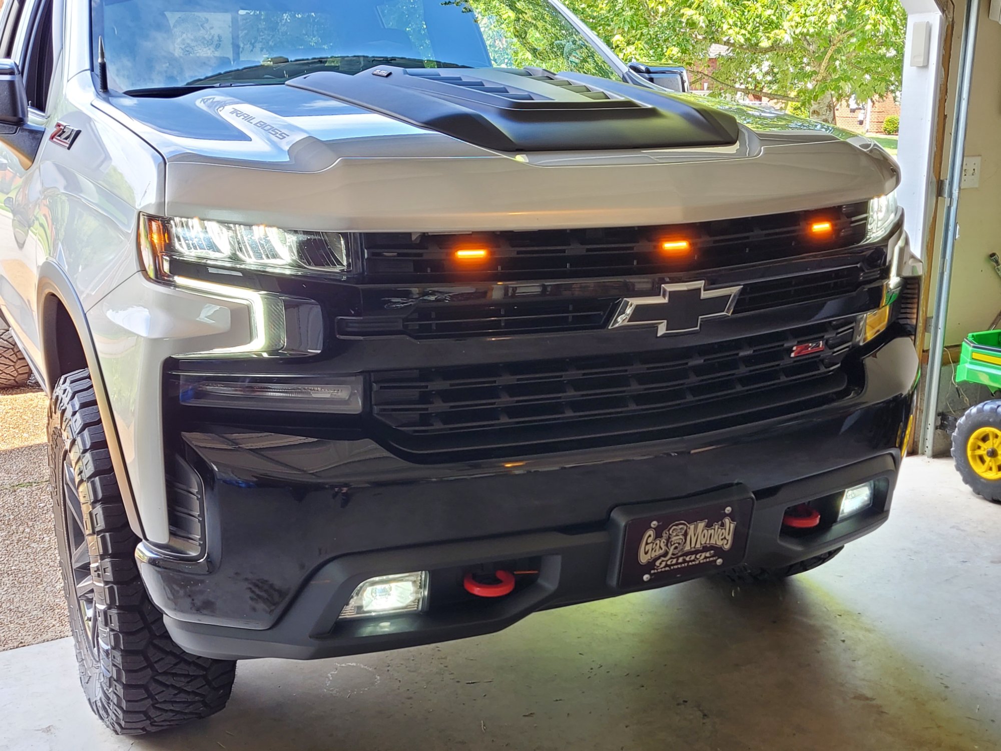

On 1/1/2022 at 12:17 PM, RedLT said:
Install mine in the same location. Turns on with the truck on and wired to where one of my homelink button can turn them off if desired.
