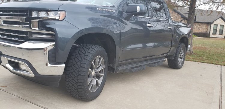

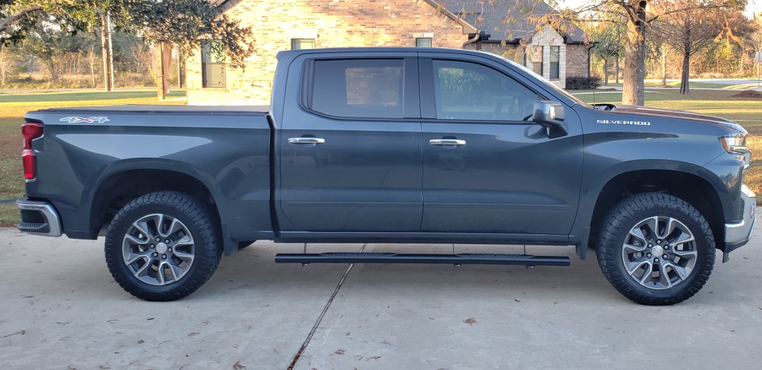

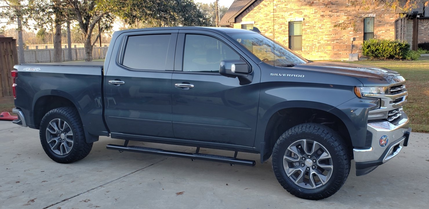

Folks I finally did it. I put on the p305/55r20s on my 6.2 LTZ max tow 4x4.  I have a 2" motofab upper spacer in the front and a 1.5 generic block in the back. My rims are the RST style that I had swapped for when I bought it.  It is damn close to rubbing on the upper control arm but about 1/4" clearance.  No rubbing on mud flaps.  I think I may replace the back block with a 2"
