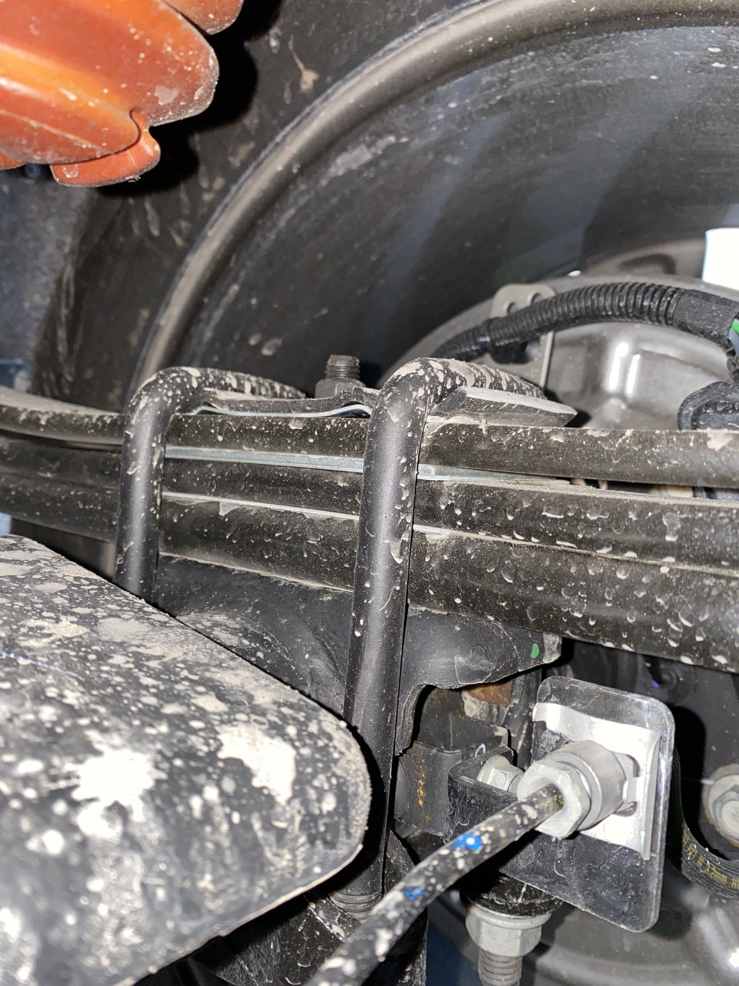

My truck is a 2020 rst 6.2L 4wd.  Has no block from the factory
This is quite interesting.  My 2019 didn't have factory blocks either but it has little 1/4" thick tapered shims.  Yours doesn't have them.  ReadyLift told me to remove them and I was hesitant to do so because everyone else with same lift has them still installed.

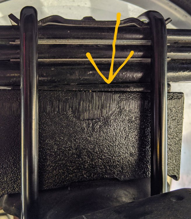

I put a 1.5 block in the rear when I did my 3 inch. It's not tapered so I left the shim in. No vibrations and so far so good.
Interesting my 2020 doesn’t have the leaf spring block nor does it have this 1/4” shim either and I have a low speed vibration between 28-10 mph. I am thinking this forward 1/4” shim would fix my pow speed vibration
