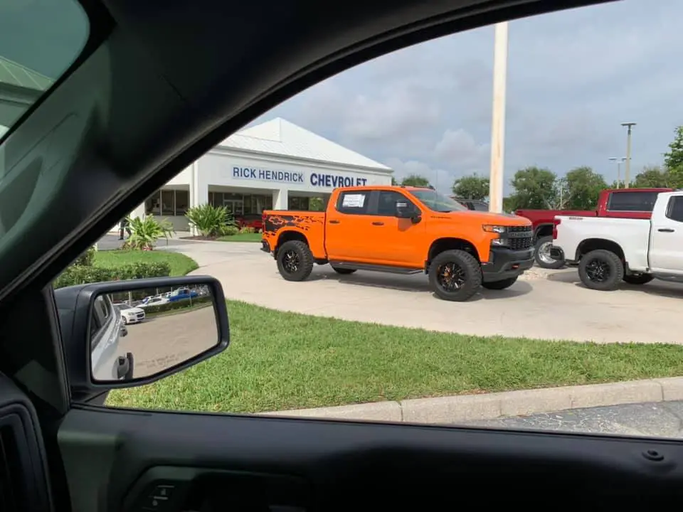

I have a 2019 1500 LTZ and was hoping to put clearance lights/cab markers on the roof of my truck. Has anyone been able to find a reputable set or company that makes them for this truck? I know I could buy some cheap universal set off Amazon and DIY but I was hoping someone made a kit designed for the 2019 with all necessary wiring harnesses.
TIA

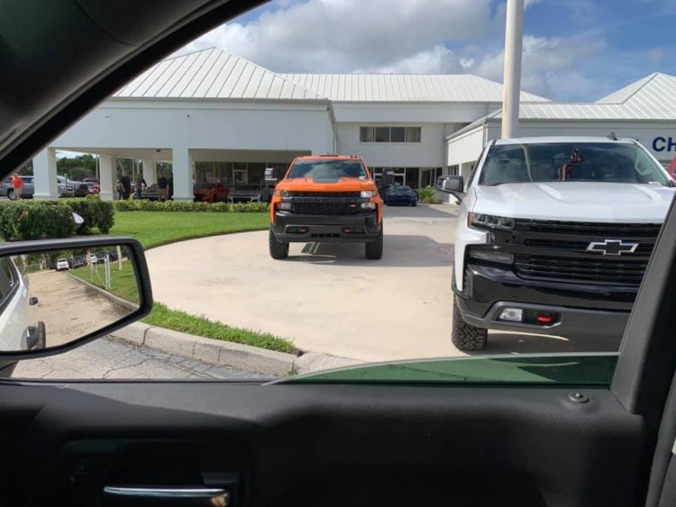

A member Eddy posted these on the facebook group.. From a dealer in Naples, FL. Looks like a custom TB with cab marker lights. Not sure how this was done but at least now you know that its been done before
Or it’s called being an enthusiast. Who cares. It may look stupid to many, but if he wants them, let him have it. You need to pull up a 2020hd vin, call the dealer with it and order the 3 lights and wiring harness that goes down the a pillar to the junction box in the kickpanel just like the other body styles.
