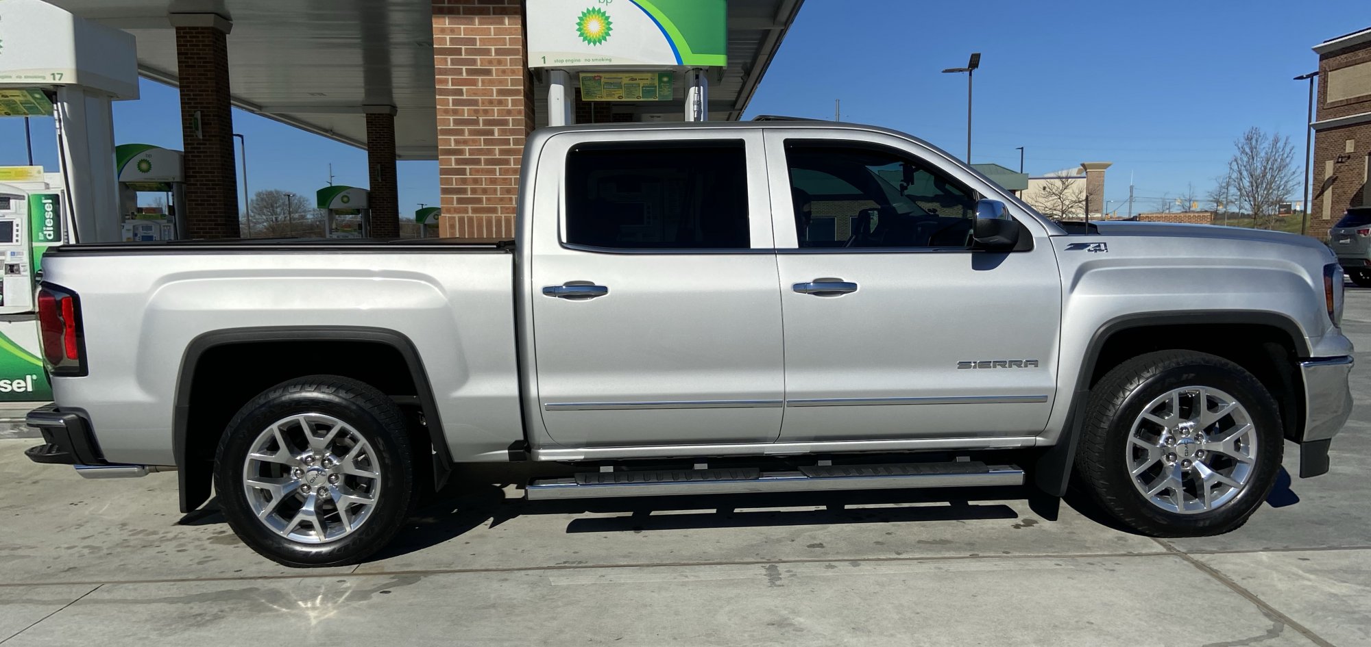

The truck is fairly level (just removed the blocks), slightly higher in the rear but a good looking stance for me. I was going to put the leveling kit on, rear blocks back and then the 60 series tire. I read enough threads on ride quality and fuel economy impact concerns that I put that idea on hold for now.

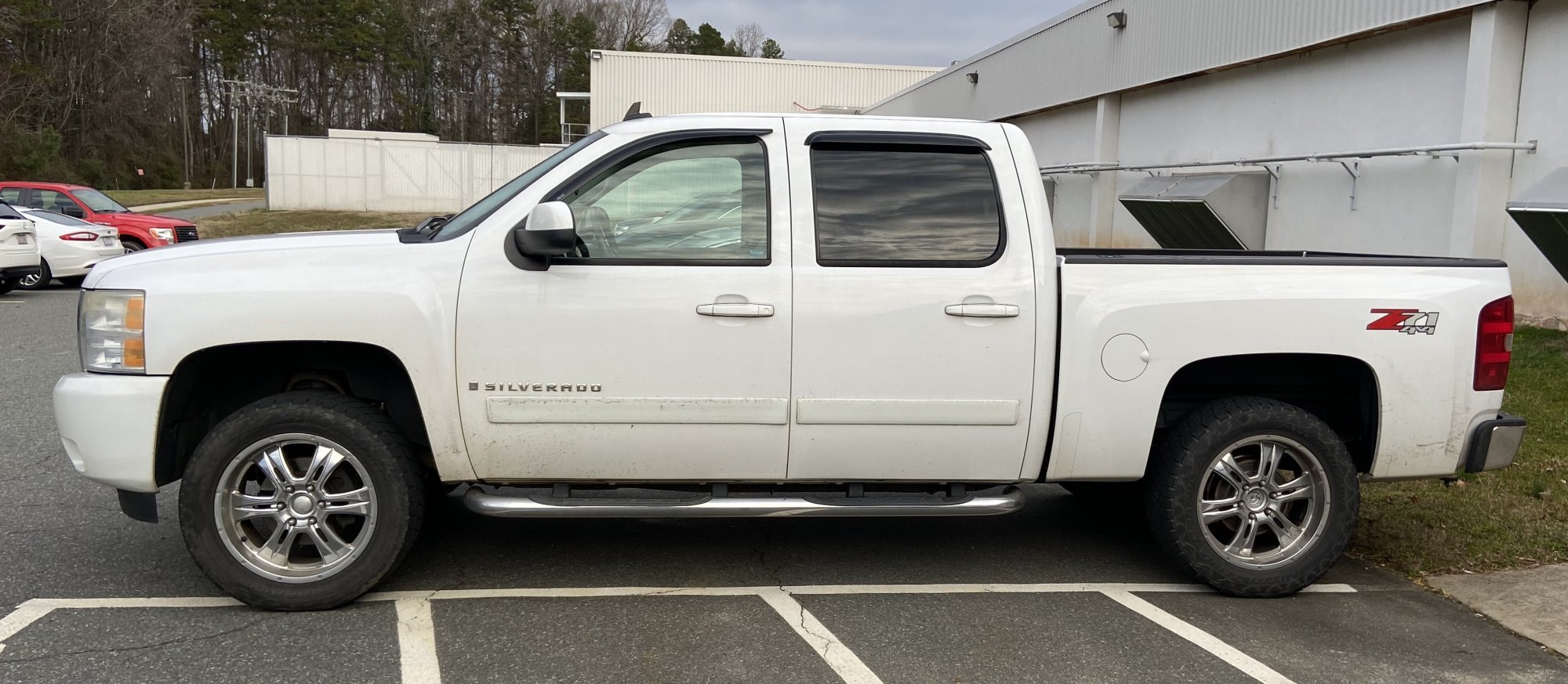

A coworked has a leveled ‘08 Silverado that I like the stance of better, more truck/4x4 looking, but he also has a more aggressive tire look that helps add to that.

Here is my Sierra with blocks removed and co-workers Silverado with strut spacers (top) to level.
He is working on getting new wheels and tires. I will try to get a pic of that, with it clean too lol
