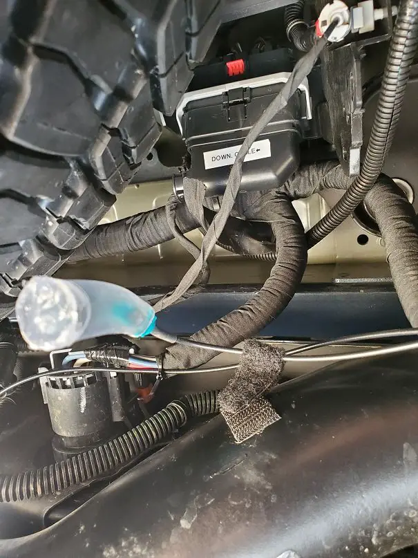

So I finally got the cameras working through a work around. I had to buy an aux camera from Camera Source for $387.85. That got my system working although the camera is not mounted. Since I cannot see the back of the bed, backing up to a trailer without the tailgate on is a hassle since you can't see the ball either. I needed to be able to disconnect and reconnect once I got to my destination to drop off my camper and connect my boat /kayak trailers. I didn't want to be climbing back under each time and again to pack up the camper so I bought an extension from Pasternack. When I take my tailgate off, I connect the jumper that remains in place routed through the bumper area. I then connect to the other end. I hang the end where the hitch cable goes. I attached a 1/2" tube over the connector to keep dirt out. I installed Velcro under to secure the end. (Note I still use a camera system mounted to my camper that displays all the time to monitor my trailers.) This is an very expensive solution for something GM should have addressed. It's a safety issue when the cameras stop working just because the tailgate is removed.

We have a 2020 GMC Denali 3500 Dually and were able get the "GMC fix".  They installed essentially a new harness and camera for $275 on the side for when the tailgate is off. All cameras work except the tailgate which was required to be blackened out. I'm not sure why it needed to be blackened out but plan to experiment placing the camera near the license plate when time allows.
Harness part #84679989 and Camera 84676845.
