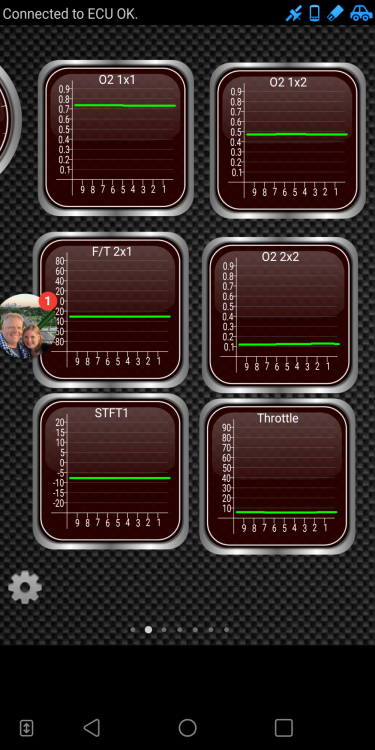

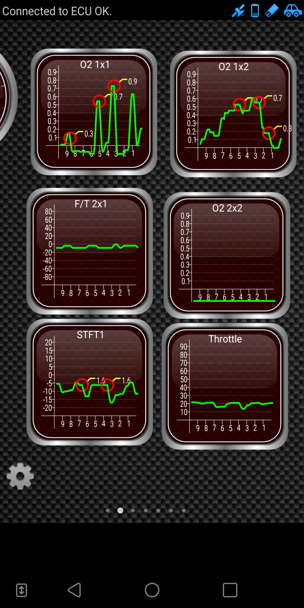

Here's a couple pics.  Wondering if it could be the coolant temp sensor or tps....  Coolant sensor reading online sounds like it causes many of the issues but not all of them.   Just strange because my o2s on bank 2 are usually 0 but just now 2x2 is pinned at max.  Also just got a p0300. Multiple random cylinders misfiring (first misfire code)  and at idle should my tps be reading 20%?  And unfortunately that sheet wasnt in my glove box so im unsure of motor.  Its a 5.3l

Can you graph the O2 Sensors?  The upstream sensors should move up and down from 200-900 or maybe 200-700 pretty steadily once warmed up and at a steady speed.  The downstream sensors should be rather steady and not move around so much.  If they do move around a lot, that particular catalytic converter is no longer doing its job.
Also run a graph or get the percentages of the LTFTs, the Long Term Fuel Trims for each bank.  Would like to see what they are at idle once warmed up.

I am using torque and it doesn't have long term fuel trims but I did the best I could to graph what you asked for I can also do individual graphs for each bank too.   This is warmed up and no sputtering or traction or stabilitrak messages.   Also I noticed on a short drive.... Stabilitrak and traction lights only come on for 5-10 min upon start up.  Sometimes will continue when at a stop light but still seems totally fine while driving

Hmm, you should be able to pull up the LTFTs, you have one STFT there in the photo.  Anyhow, when the truck is running, what are O2 1x1 and 2x1 doing?  Looking for data on upstream O2 sensors.  Are they constantly moving up and down?
Now for the downstream sensors, they should be more steady, O2 1x2 and 2x2 I think they'll be.
Now with the misfires, can it tell you which cylinders and how often?  How about the knock sensors?

Misfire code says random and multiple cylinders but won't do individual cylinders... I'm guessing bank 2 and I can't remember if thats odd or even cylinders. And I cant find the lifts anywhere just short term.  This pic is warm at about 2000 rpm going down the hwy
I can't check alcohol levels either.... I think k it's time for a better reader.   Also i had 1extra  oem o2 sensor that I'm going to put in 2x2 at lunchScreenshot_20200206-092854.thumb.png.a49b7bf4ceeb7f66fa18d5340ae5c833.png

Ok, well, your downstream O2 sensor on the passenger side is dead, not reading.  Are these ACDelco sensors?  Upstream sensors are 12583804/213-3866 and downstream or rear sensors are 12609457/213-4229.  Can you swap them to the other side?  With a proper scan tool or the app set up right, you should be able to see the misfire count on each individual cylinder.
Your driver's side O2 sensors appear to be operating perfectly.  Your Short Term Fuel Trims on the driver's side might be alluding to something being amiss, like a vacuum leak.  Your TPS being at 20% is also not right, should be 2%-7% or so but may be compensating for an error and since there are no codes for it, something to keep an eye on.
