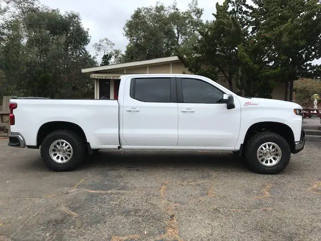

First off, I wanted to get the front end to the height it would end up at with my future plans. I purchased the Moto Fab 3" leveling top strut mount spacers because (1) That's the amount of lift the new suspension and King coilover shocks will give me and (2) They seem  to be more stout than the plastic lower strut mount spacer option.

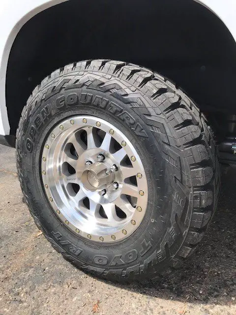

Next, it was time to get some real hikin shoes on her. In anticipation for the new suspension requiring wheels with a minimum of 4.75". I ended up finding a set of 5 bran new Method Double Standards with Toyo Open Country R/T tires mounted for a killer deal on the http://www.race-dezert.com Classifieds section. In the end I had to add 1/2" wheel spacers on the front wheels since the wheel just barely contacted the brake caliper and 1/2" spacers were the smallest I could find. Breaks my heart to have to use wheel spacers but....what're ya gonna do?
Wheels: Method 304 Double Standard (machine finish) 17x8.5
Tires: Toyo Open Country R/T 285/70/17

After looking at the truck for a couple weeks all raked out like it is (sat 1.75" higher in the front) I decided to install a 1" lift block under the leaf springs to ease up on the rake a bit.
https://vod.ebay.com/vod/FetchOrderDetails?itemid=252445736848&transid=2535146040015&ul_noapp=true
